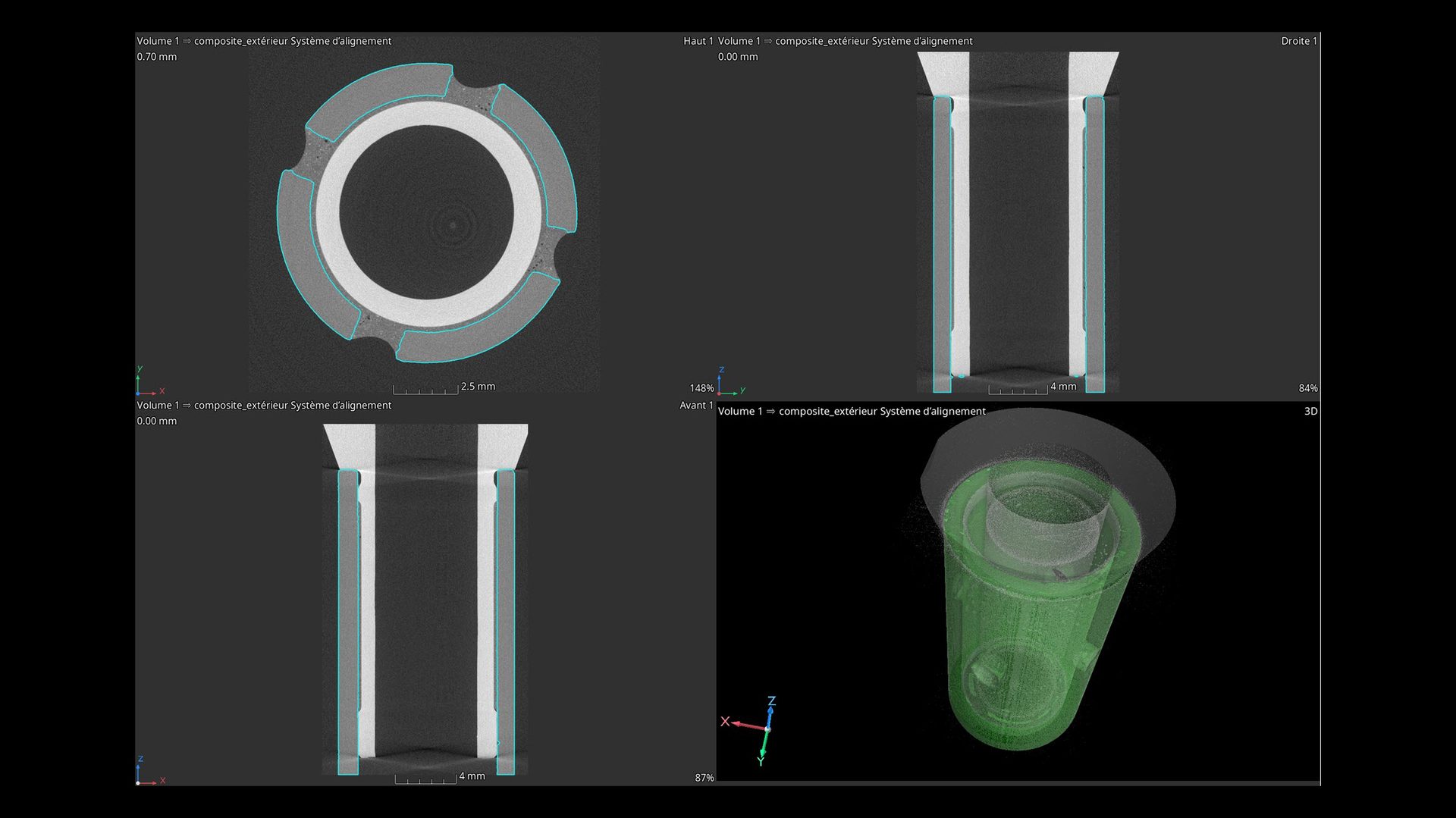

Advanced CT analysis software
Industrial CT-scanning systems and analysis software are providing faster insights into manufactured components. By Jan Gräser

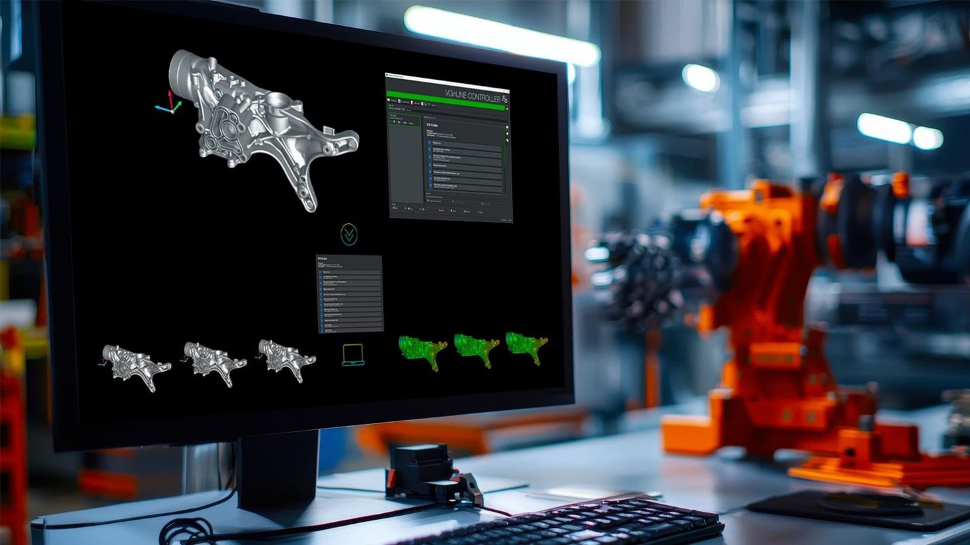

Image 2. Holistic visualization and analysis software enables automatic execution of inspection tasks in a nondestructive production environment. Results can be connected to existing systems for fully autonomous quality monitoring. Image courtesy of Hexagon

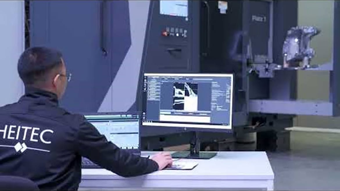

Image 1. An engineer monitoring a robotic CT scan and analysis system as it inspects a manufactured component. Image courtesy of Heitec
ImageAn engineer monitoring a robotic CT scan and analysis system as it inspects a manufactured component.

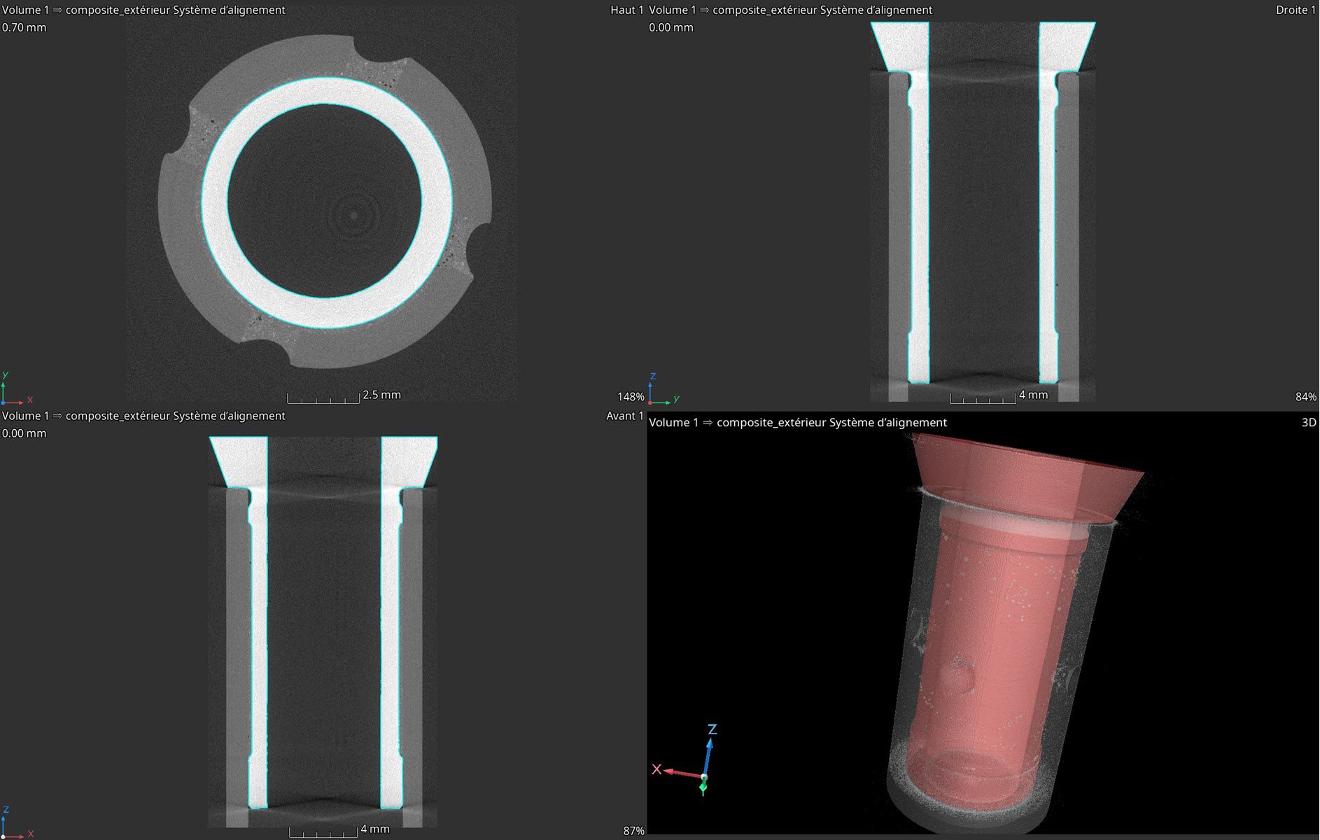

An example of CT-scan data analysis of an automotive part.
Image 5. An example of CT-scan data analysis of an automotive part. Image courtesy of Heitec
How In-Line CT Quality Inspection Works
During quality testing with in-line computed tomography (CT), an X-ray source emits radiation that penetrates objects and is attenuated depending on the material and geometry of the workpiece to be tested. A detector attached at the opposite side of the source creates a shadow image of the workpiece from the remaining radiation; the varying grey tones of the shadow images represent the differences in the nature of the test specimen. Control software then generates a 3D model of the object from the 2D X-ray image stacks. Finally, holistic analysis and visualization software is used to view and analyze the digital model from a variety of specific perspectives to either detect potential faults or to certify acceptable quality.
