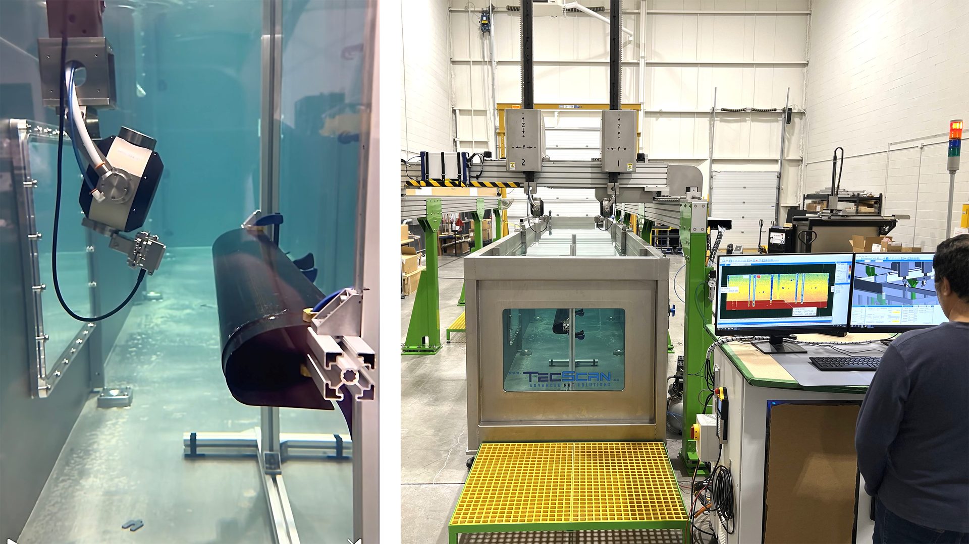

Gantry system with 3D and contour following scanning capabilities
Advanced ultrasonic testing solutions must keep pace with these new challenges while maintaining the rigorous quality control standards that ensure aircraft safety. By René Sicard and Ahmad Chahbaz

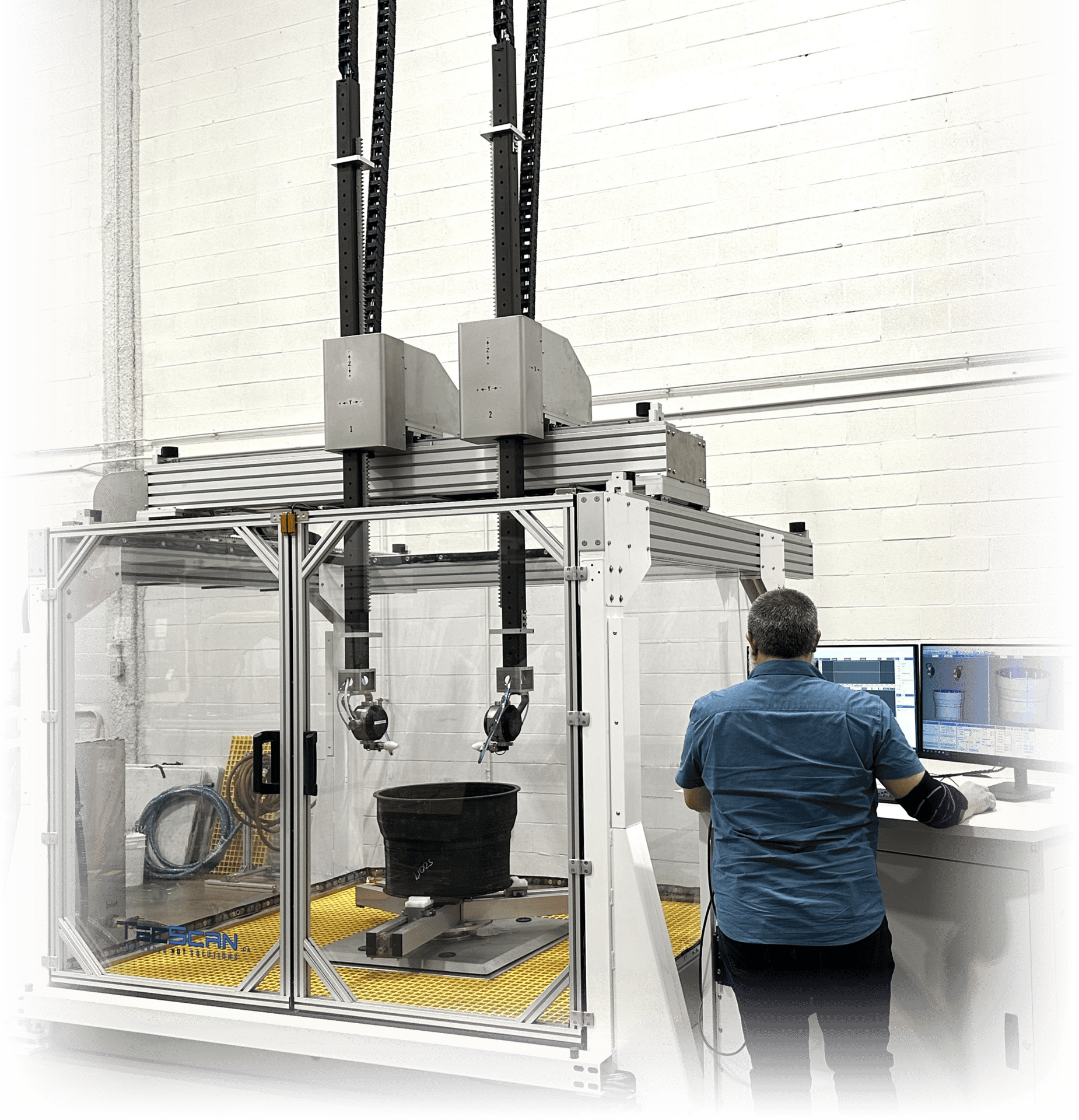

Ultrasonic testing of aerospace components with complex 3D geometries requires advanced control tools to achieve precise and comprehensive scanner control. For example, UT immersion tanks and squirter gantry systems integrate contour-following capabilities and multi-axis motion control to ensure accurate UT inspection coverage. These systems can also be equipped with 3D Scanning capabilities using advanced path-planning algorithms to adapt to intricate surface profiles, enabling full volumetric inspection. Additional scanner control capabilities and tools are also required to monitor and maintain the ultrasonic probes alignment to achieve proper scanning resolutions.

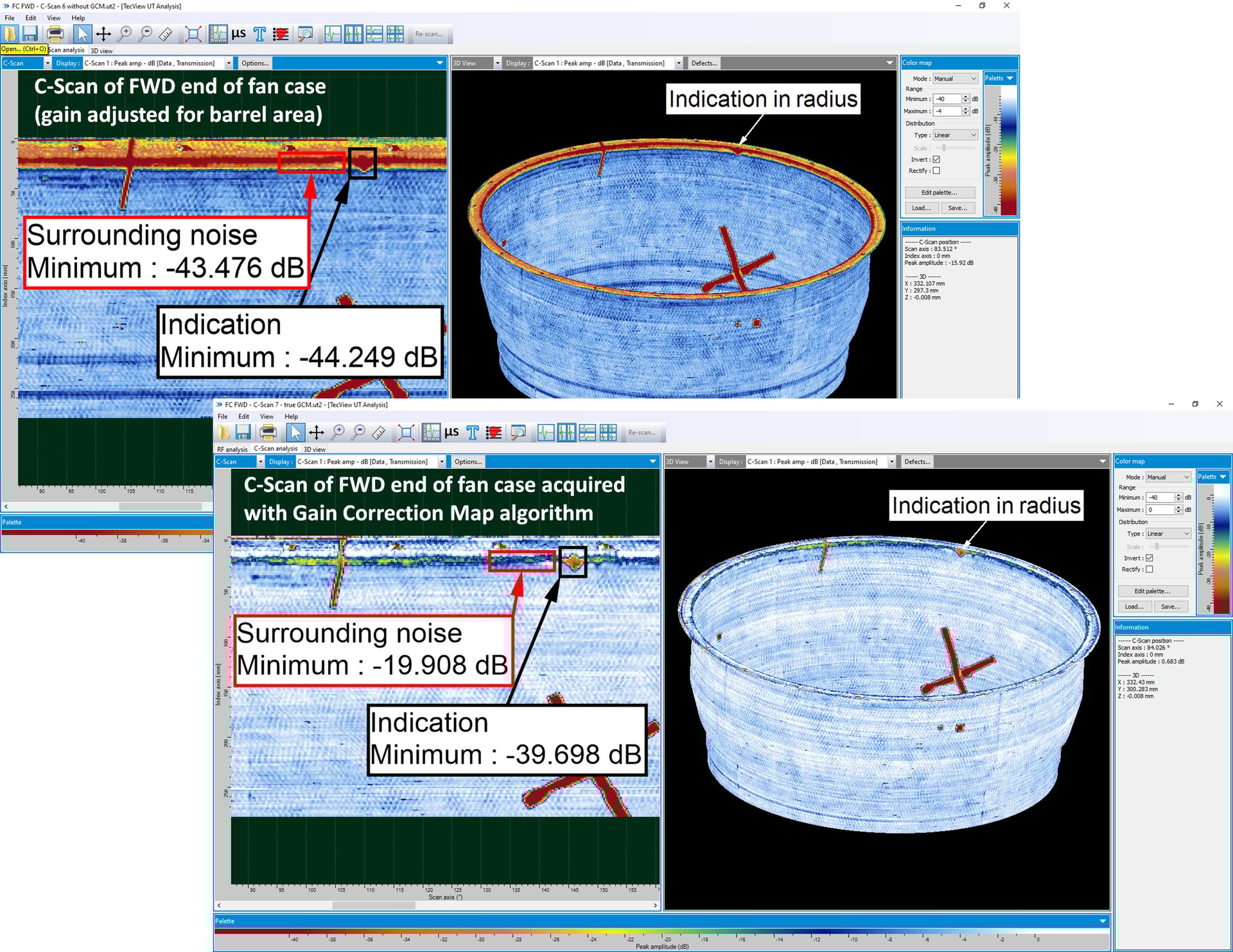

Finally, the accuracy of any nondestructive testing (NDT) solution relies on robust results interpretation tools. Advanced data processing software must be capable of analyzing vast amounts of inspection data, filtering out noise, and highlighting potential defects with high precision. Intelligent algorithms, 3D visualization, and user-driven analysis further improve defect detection, ensuring reliable results that meet aerospace quality standards.

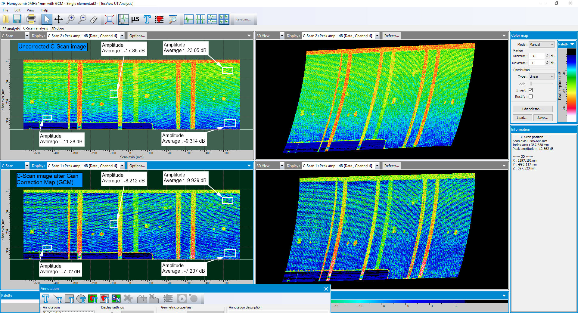

A key example of such analysis tools is the gain correction map algorithm, which allows us to account for natural signal attenuation in complex geometries by dynamically adjusting the receiver gain as the probe(s) move across the surface of the inspected part or component. This is based on a pre-calibration of the attenuation occurring naturally on the part.
C-Scan results of composite structure with Gain Correction Map
Fig. 3. C-Scan results of composite structure with Gain Correction Map

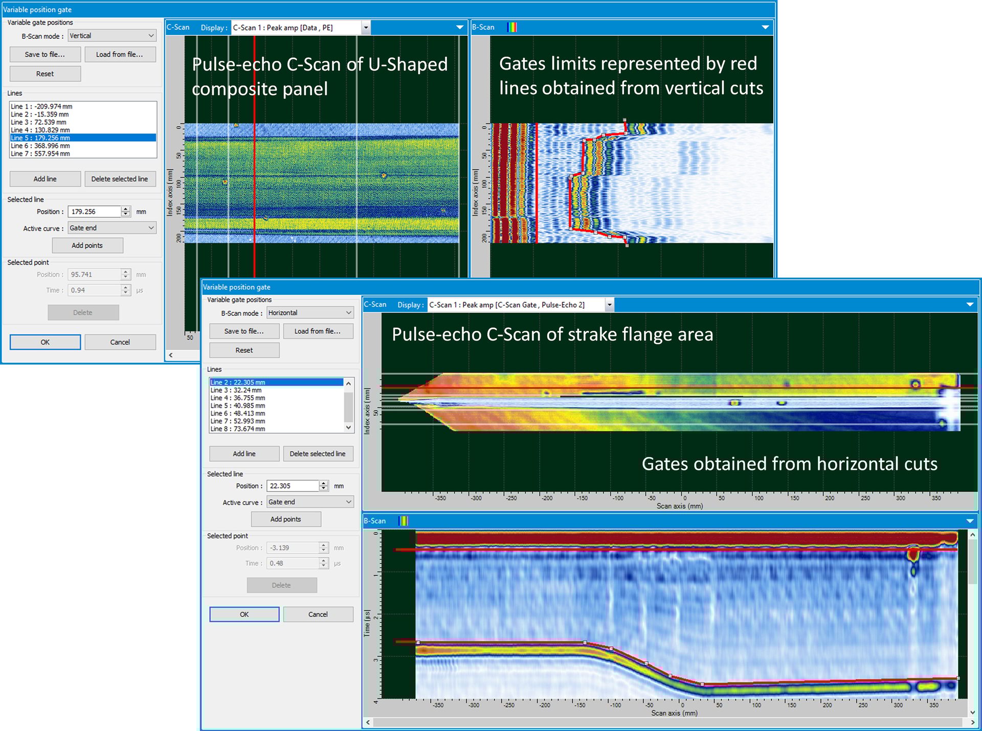

Variable signal gating is another essential tool, particularly when variations in component thickness prevents from using simple gates to detect indications without interferences from the back wall echo. With position-dependent gating, the detection gate dynamically adjusts based on the B-Scan representation, following the component thickness.
Examples of variable inspection gating using TecView for composite U-Shape and Strake parts
Fig. 4. Examples of variable inspection gating using TecView for composite U-Shape andStrake parts

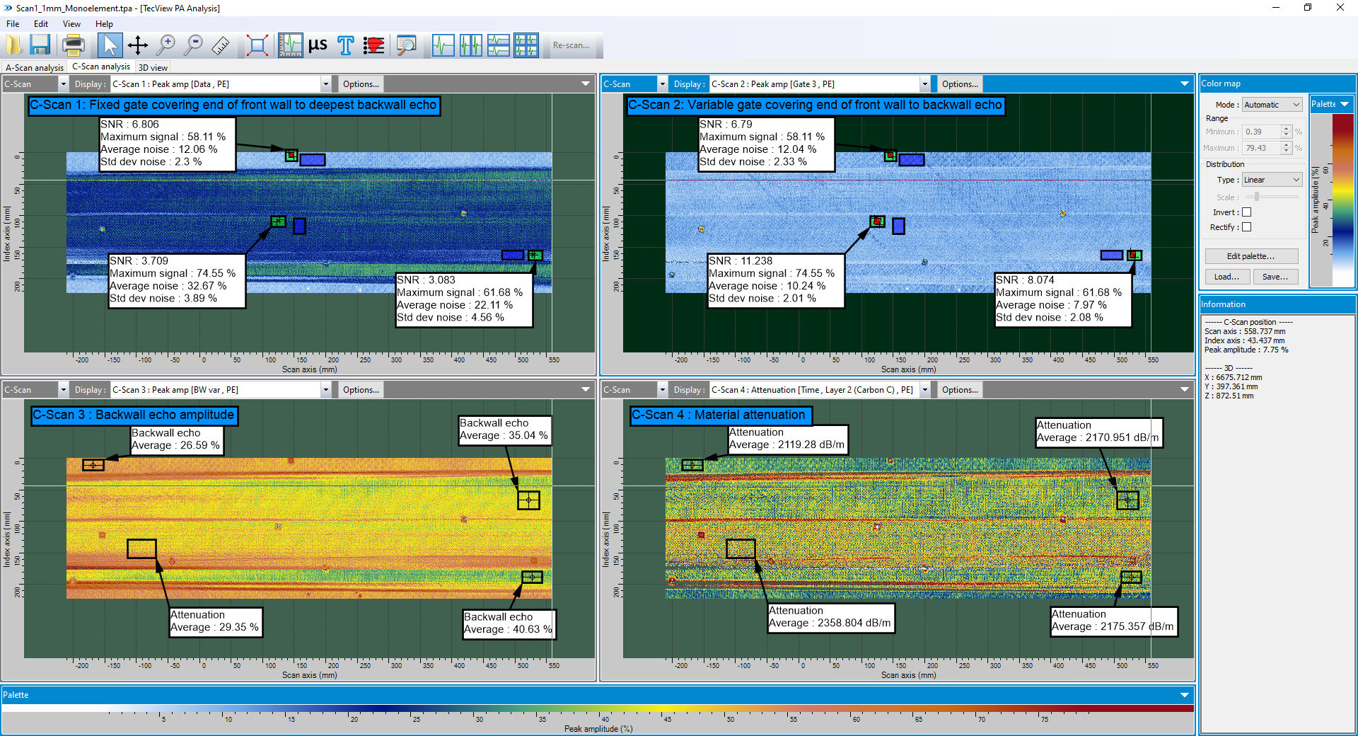

Since porosity is often monitored in carbon composite laminates, backwall echoes attenuation must be analyzed. This can be done by evaluating the acceptable dB drop for each thickness range or calculating the attenuation per units of thickness.
Different C-Scan representations resulting from the inspection of the U-Shaped carbon composite panel. C-Scan 1 (top-left) and C-Scan 2 (top-right) illustrate the benefit of using variable gate
Fig. 6. Different C-Scan representations resulting from the inspection of the U-Shaped carbon composite panel. C-Scan 1 (top-left) and C-Scan 2 (top-right) illustrate the benefit of using variable gate
In the above example of Fig. 6, the benefits of variable gating (C-Scan 2, top-right) for the detection of internal indications is illustrated by comparison to a fixed gate (C-Scan 1, top-left). Porosity characterization can also benefit from a conversion of backwall amplitude (C-Scan 3, bottom-left) to attenuation data (C-Scan 4, bottom-right). While direct backwall amplitude must be compared to the expected signal amplitude or drop corresponding to the thickness of a specific area, attenuation provides a reading that is independent from thickness. This is beautifully illustrated in this example, where large variations observed on the backwall amplitude are not relevant when converted to attenuation, especially for the lowest monitored backwall amplitude which converts to the lowest attenuation.

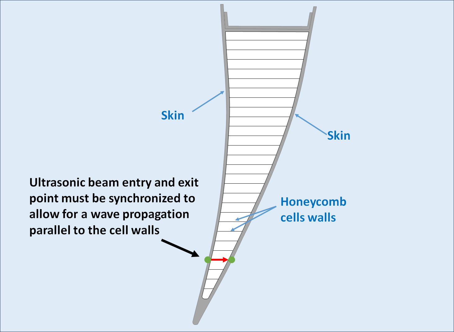

Aircraft wing flaps represent another example of 3D composite panels requiring advanced tools to obtain optimal scan results. The sample presented below is an aluminum honeycomb core bonded to curved aluminum skins, scanned in a through-transmission setup using a pair of phased array probes.
Due to its curved shape, 3D contour following is necessary. However, the presence of the honeycomb structure complicates the scanning trajectories calculation. As an example, the general cross-sectional shape of a wing flap is presented in Fig. 8; as illustrated by the parallel lines, the honeycomb cell walls run through the thickness independently from the angle of the skin surface. In addition, the thickness of the honeycomb structure varies along the part profile, leading to variations of ultrasonic attenuation.
Ultrasonic waves can only propagate through the walls of the honeycomb cells, which means that the emitting and receiving probes locates on both sides of the sample must align with the cell’s walls to get proper transmission through the thickness. Consequently, the motion control software must allow to associate entry and exit points that are aligned with the core cells in the calculation of scanning trajectories. Phased array scanning is also beneficial to minimize scanning time on such large structures. This requires state-of-the art algorithms to manage data acquisition of phased array on curved surfaces that preserves the true dimensions of the part.
Cross-section of a wing flap illustrating the variations of honeycomb cell walls vs skin layers
Fig. 8. Cross-section of a wing flap illustrating the variations of honeycomb cell walls vs skin layers
Since the thickness of the honeycomb structure is not the same everywhere and the direction of propagation of ultrasounds inside the part is not necessarily achieved with optimal entry and exit angle at the skin surface, significant differences in wave attenuation can occur across the part. A gain correction map function that dynamically corrects the gain as a function of local attenuation represents a highly valuable tool for such structure. By correcting the gain as a function of scanning position, a strong signal can be maintained across the part, leading to the same amplitude accuracy and an optimal signal-to-noise ratio at any position. Benefits of this technique are illustrated in the C-Scan images of Fig. 9, which were acquired on a wing flap sample, both without and with the gain correction map.
Comparison of pre and post application of the Gain Correction Map on an aircraft wing flap in TecView
Fig. 9. Comparison of pre and post application of the Gain Correction Map on an aircraft wing flap in TecView

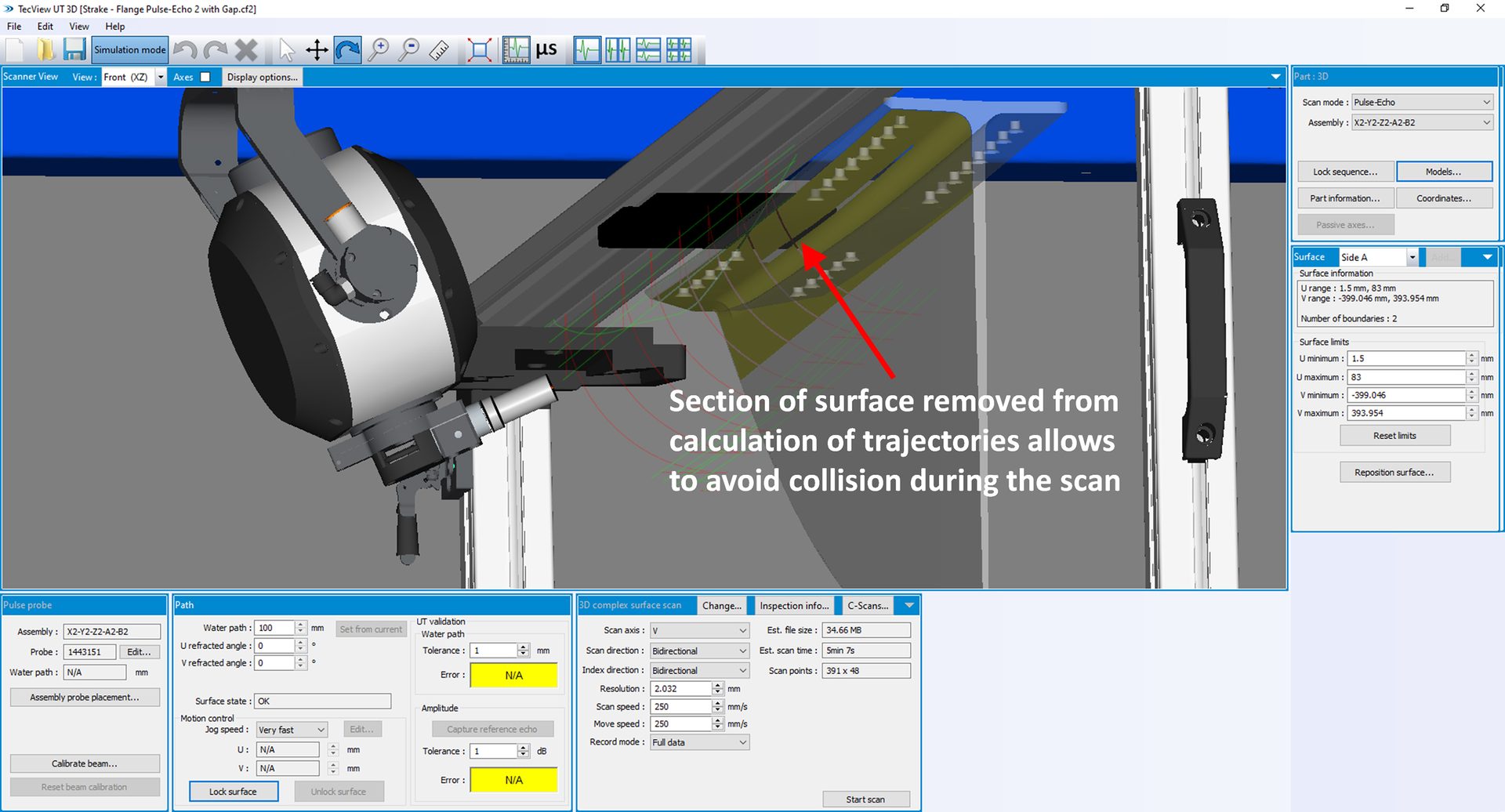

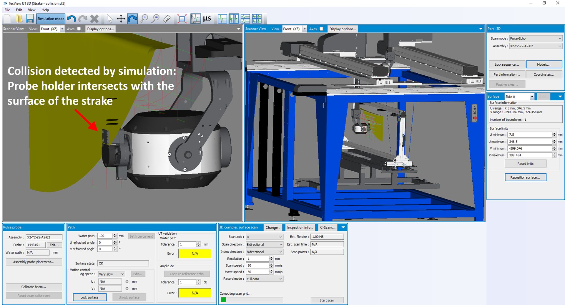

Another particularity of the strakes and chines is the tight radius of the transition between the fin and the flange. Scanning surfaces at and around the flange radius therefore presents high risks of interference between the probe gimbal manipulator and the part.
Example of identification of collision in TecView 3D display environment from the intersection of the scanner model with the inspected part model
Fig. 11. Example of identification of collision in TecView 3D display environment from the intersection of the scanner model with the inspected part model

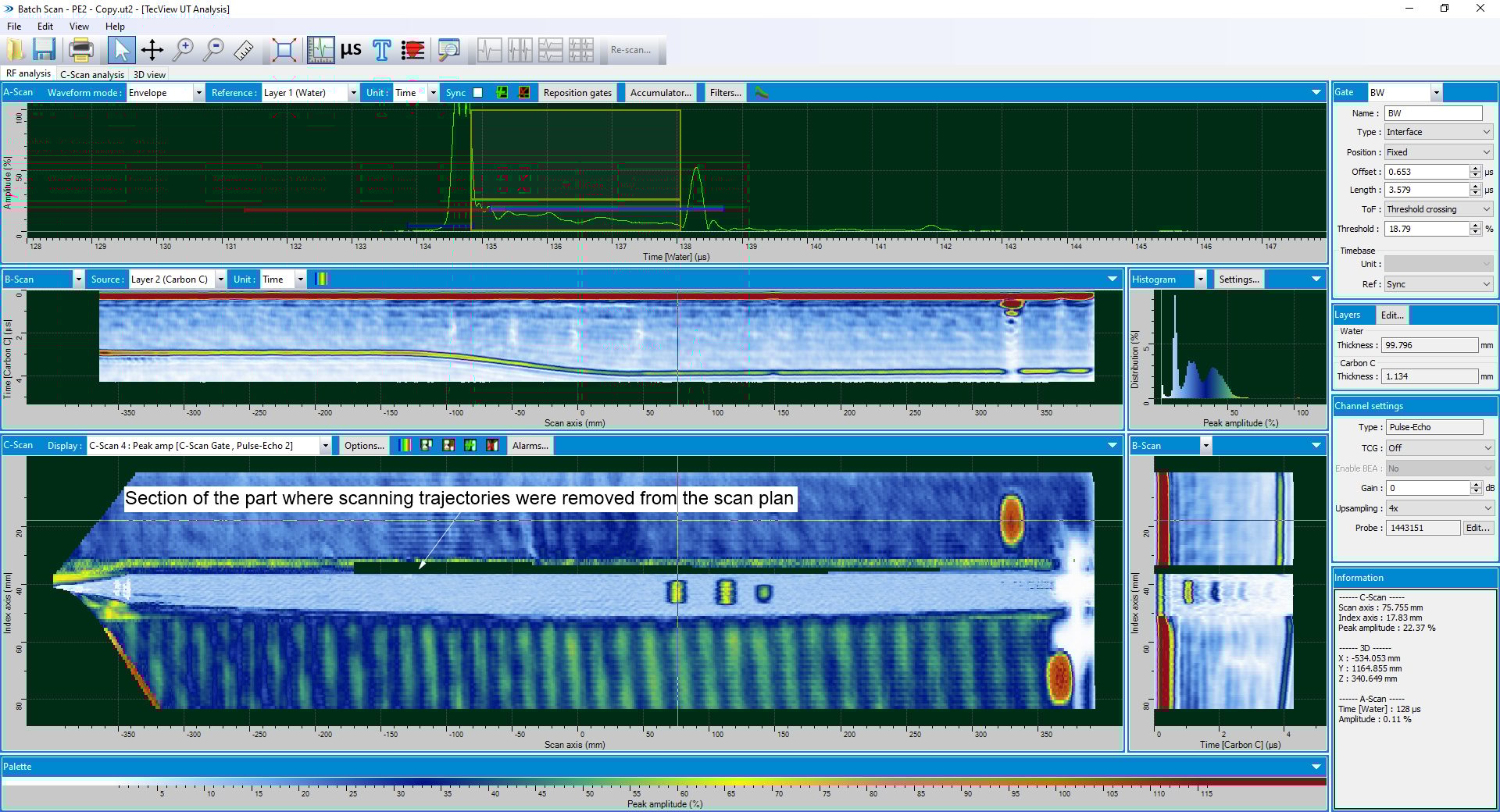

This is where accurate simulation tools become essential in the preparation of the scan setup. Collisions can be identified by simulating the movement of the probe around the radius at the required water column and angle and trajectories can be modified to avoid such interferences. This exercise leads to an optimization of the scanning time by maximizing areas of the part that can be scanned automatically, while identifying areas where a complementary manual inspection may be necessary. In the example below, a section of surface identified by simulation and leading to collisions has been removed from the scanning area, thus avoiding the problematic trajectories.
Display of the inspection area after removal of the scanning positions responsible for mechanical interference illustrated in Fig. 10.
Fig. 12. Display of the inspection area after removal of the scanning positions responsible for mechanical interference illustrated in Fig. 10.
Pulse-Echo C-Scan resulting from the inspection of the strake sample after removal of the problematic scanning positions.
Fig. 13. Pulse-Echo C-Scan resulting from the inspection of the strake sample after removal of the problematic scanning positions.

Opening Image: Fig. 1. Gantry system with 3D and contour following scanning capabilities
