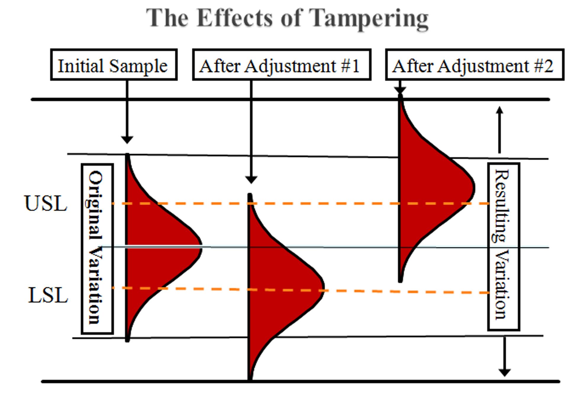

a. When only common causes are present, then no action should be taken based on the value of any current sample. We ignore the sample-to-sample variation within the control limits. If the current process is undesirable, we need to redesign the process to reduce common cause variation.\u003cbr />b. When a special cause occurs, then we act to determine the conditions currently present that have influenced the process to behave differently. If the new behavior is undesirable, we should seek to remove the condition responsible. If the new behavior is favorable, we should look to standardize on this new condition as a means of process improvement.\u003c/li>\u003cli >Control limits provide a statistical basis for the Run Test rules, developed initially by Western Electric as an improvement to the control chart. These Run Test rules provide improved detection of special causes, primarily by looking for patterns in the data within the control limits that are statistically unlikely to occur unless a special cause is present. While these are more cumbersome to use in a paper-based system than the simple comparison to the control limits, when you’re using SPC software to monitor your process, these can be automatically applied for a no-hassle benefit to the chart. \u003c/li>\u003c/ol>\u003cp >What happens if you’re not using a control chart and you respond to common cause variation as if it were a special cause and adjust or change the process? Deming discussed this using his funnel experiment (Deming, 1982), where he would mark a target on a flat table, then drop a marble from a funnel onto the table from a designated height and note the difference from the drop point to the target. Adjust the process using one of four strategies, and repeatedly use this same strategy for 50 drops. His four adjustment strategies, examples of their use and their results are as follows:\u003c/p>\u003col >\u003cli >Strategy 1: No adjustment to the funnel position. This is the same strategy described for the control chart, where no adjustment is made when the process is influenced by only a common set of conditions. This results in a stable distribution of points, with the minimum possible amount of variation.\u003c/li>\u003cli >Strategy 2: Adjust the funnel position by moving it from the current position toward the target by the amount equal to the difference between the drop point and the target. This is the most common strategy for process adjustment and is illustrated in Figure 2. This occurs when you try to “control” the process using specifications rather than statistical control limits. This tampering with the process results in a stable distribution of points, but with twice the variance experienced via Rule 1. (Mathematically, it can be shown the variance is doubled, which results in the process standard deviation increasing by 40%). In other words: You’ve just increased your defect rate substantially!\u003c/li>\u003cli >Strategy 3: Adjust the funnel position by moving it the opposite direction, a distance from the target equal to the difference between the drop point and the target. For example, the most recent data was 20 units above target, so adjust the process by -20 so it will now be on target. This results in ever-increasing (unstable) movement of the process from target, oscillating in one direction then the other. \u003c/li>\u003cli >\u003cdiv style=\"position:relative\">Strategy 4: Adjust the funnel to position it directly over the last drop point. This strategy is more common than you might imagine, with examples cited by Deming including operators who try to reduce variation by making the next piece like the last, or managers who train workers using the recently trained as trainers. This also results in an unstable, ever-increasing movement of the process from target in one direction. This is known statistically as \u003cem >the random walk, \u003c/em>which is often described by the metaphor of a drunk trying to walk home, falling at each step, and restarting the next step in a random direction, going further and further off course with each step. Doesn’t end well for the drunk either.\u003c/div>\u003c/li>\u003c/ol>"},"type":"text","cl":"text pROFMlP3ix"},{"key":"e9WTm1Ia-LE","type":"section","children":["e84LRG5oh8y"],"cl":"section"},{"key":"e2HUSH0IWYl","content":{"margin":20,"backdrop":{"r":255,"g":255,"b":255,"a":0.8},"children":[]},"type":"zoom","cl":"zoom"},{"key":"eg12sfFdYhp","content":{"src":{"key":"juQjclsbsi","url":"https://cdn.vev.design/cdn-cgi/image/f=auto,q=82,w=1920/private/TrZjorIyzFVHDIUpGHunL0PSQdM2/image/juQjclsbsi.jpg","ratio":1.394700139470014},"children":[]},"type":"image","actions":["e2HUSH0IWYl"],"cl":"image"},{"key":"ekmReb67NO8","content":{"text":"\u003ch1 >Figure 2. The Effects of Tampering. \u003c/h1>","children":[]},"type":"text","cl":"text paLhyLoArH"},{"key":"eTXfnHJfPLr","content":{"children":[]},"type":"frame","children":["eg12sfFdYhp","ekmReb67NO8"],"cl":"frame"},{"key":"e3yAJ58JA_T","content":{"speed":66,"children":[]},"type":"w1c3kqru4r-1p7v","children":["eTXfnHJfPLr"],"cl":"w1c3kqru4r-1p7v"},{"key":"e97_k_Re6Vz","content":{"text":"\u003cp >Wheeler recently wrote of the applications of several funnel-type adjustment strategies as they relate to the use of automated PID controllers (\u003cem >Can We Adjust Our way to Quality, Parts 1 & 2\u003c/em>, Quality Digest). Many engineers incorrectly surmise that these automated techniques are superior to manual techniques in somehow preventing the entirely predictable increase in process variation due to unnecessary adjustments (noted as Strategy 2, above). Unsurprisingly, his conclusions mirrored Deming’s: The no-adjustment strategy achieves the least variation, whether the process is influenced by common cause variation only or influenced by both common and special causes. \u003c/p>\u003cp >It should be clear that the control chart provides the means to learn about our process.\u003c/p>\u003cp >In fact, it is \u003cstrong >the fundamental tool of process analysis\u003c/strong>. No other statistical tool, such as confidence intervals, can be used to estimate process variation, as those tools ignore the element of time, a fundamental aspect of a process. This is the power and exclusive domain of the control chart, which is a necessary precursor for every process improvement activity. Despite your best intentions, you cannot improve a process without first differentiating between common and special causes, as your reaction to each must be different. You cannot effectively implement Lean without the predictability provided by a controlled process. As Deming said: “The distribution of a quality-characteristic that is in statistical control is stable and predictable, day after day, week after week. Output and costs are also predictable. One may now start to think about Kanban or just-in-time delivery.” (Deming, pg. 333).\u003c/p>"},"type":"text","cl":"text pROFMlP3ix"},{"key":"erMKQBzaWem","type":"section","children":["e97_k_Re6Vz"],"cl":"section"},{"key":"eZiXcf8mtJx","content":{"text":"\u003ch4 >\u003cem >Opening Dial Image Source: \u003c/em>Ivan Sherstiuk / iStock / Getty Images Plus via Getty Images.\u003c/h4>\u003ch4 >\u003cem >Opening Background Image Source: \u003c/em>mypokcik/iStock/ Getty Images Plus via Getty Images.\u003c/h4>\u003ch4 >Figures 1 and 2\u003cem > Source: Quality America \u003c/em>\u003c/h4>"},"type":"text","cl":"text p9ADI1APNg"},{"key":"eZbZ9RULK_0","type":"section","children":["eZiXcf8mtJx"],"cl":"section"},{"key":"enxWKk52awg","content":{"cont":{"tablet":{"params":{"trigger":"Load","updated":1617201661296,"LoadAnimation":{"duration":0.6,"delay":0,"once":true,"translateX":["300px","0"],"preset":"slideInLeft","opacity":[0,1],"easing":"easeOutQuart"}}},"desktop":{"params":{"trigger":"Load","updated":1617201661296,"LoadAnimation":{"duration":0.6,"delay":0,"once":true,"translateX":["300px","0"],"preset":"slideInLeft","opacity":[0,1],"easing":"easeOutQuart"}}},"mobile":{"params":{"trigger":"Load","updated":1617201661296,"LoadAnimation":{"duration":0.6,"delay":0,"once":true,"translateX":["300px","0"],"preset":"slideInLeft","opacity":[0,1],"easing":"easeOutQuart"}}}}},"type":"w75y8u1c","cl":"w75y8u1c"},{"key":"enYxCttP2P5","content":{"text":"\u003ch1 >Paul Keller is president of Quality America, a publisher of software and training for Six Sigma Quality Improvement. He has written several books, including SPC Demystified (McGraw Hill, 2011), Six Sigma Demystified (McGraw Hill, 2005, 2011) and the third through sixth editions of The Six Sigma Handbook (McGraw Hill, 2009-2024). For more information, email \u003ca href=\"mailto:pkeller@qualityamerica.com\">\u003cu >pkeller@qualityamerica.com\u003c/u>\u003c/a> or visit \u003ca target=\"_blank\" href=\"http://www.qualityamerica.com/\">\u003cu >www.qualityamerica.com\u003c/u>\u003c/a>.\u003c/h1>"},"type":"text","actions":["enxWKk52awg"],"cl":"text pokWubE7CO"},{"key":"ekuZaLzfgBp","content":{"shapeId":"riS-THb8c"},"type":"shape","cl":"shape"},{"key":"ecCtYVIgBiv","content":{"shapeId":"7aRQpbvm9"},"type":"shape","cl":"shape"},{"key":"eI0pK0Pt_cg","content":{"cont":{"tablet":{"params":{"trigger":"Load","updated":1617201191978,"LoadAnimation":{"duration":0.6,"delay":0,"once":true,"translateY":["0px","0px"],"translateX":["-300px","0px"],"scale":1.03,"stagger":[0.15,"last"],"preset":"staggerSlide","event":"bot","easing":"linear"}}},"desktop":{"params":{"trigger":"Load","updated":1617201191978,"LoadAnimation":{"duration":0.6,"delay":0,"once":true,"translateY":["0px","0px"],"translateX":["-300px","0px"],"scale":1.03,"stagger":[0.15,"last"],"preset":"staggerSlide","event":"bot","easing":"linear"}}},"mobile":{"params":{"trigger":"Load","updated":1617201191978,"LoadAnimation":{"duration":0.6,"delay":0,"once":true,"translateY":["0px","0px"],"translateX":["-300px","0px"],"scale":1.03,"stagger":[0.15,"last"],"preset":"staggerSlide","event":"bot","easing":"linear"}}}}},"type":"w75y8u1c","cl":"w75y8u1c pgxkEqrg4x"},{"key":"e9PxlkO2PLE","type":"frame","actions":["eI0pK0Pt_cg"],"children":["ekuZaLzfgBp","ecCtYVIgBiv"],"cl":"frame"},{"key":"eXP3zTEdLiD","type":"frame","children":["enYxCttP2P5","e9PxlkO2PLE"],"cl":"frame"},{"key":"eYPkjzOr75y","type":"section","children":["eXP3zTEdLiD"],"cl":"section"},{"key":"ex-XlN-2IG9","content":{"children":[]},"type":"rectangle","cl":"rectangle"},{"key":"emxlZaHrnfX","content":{"text":"\u003ch2 >UP NEXT\u003c/h2>","children":[]},"type":"text","cl":"text phkDpg-xDX"},{"key":"e-ooUd685Dy","content":{"text":"\u003ch2 >Professor Quality \u003c/h2>","children":[]},"type":"text","cl":"text phkDpg-xDX"},{"key":"erTg8mg2S6y","content":{"children":[],"cont":{"tablet":{"params":{"trigger":"Load","updated":1696525323325,"LoadAnimation":{"duration":2,"delay":0,"once":true,"loop":false,"preset":"fadeIn","opacity":[0,1],"easing":"easeOutQuad"}}},"desktop":{"params":{"trigger":"Load","updated":1696525323325,"LoadAnimation":{"duration":2,"delay":0,"once":true,"loop":false,"preset":"fadeIn","opacity":[0,1],"easing":"easeOutQuad"}}},"mobile":{"params":{"trigger":"Load","updated":1696525323325,"LoadAnimation":{"duration":2,"delay":0,"once":true,"loop":false,"preset":"fadeIn","opacity":[0,1],"easing":"easeOutQuad"}}}}},"type":"w75y8u1c","cl":"w75y8u1c"},{"key":"eGXkOrY32o2","content":{"shapeId":"ZBBXEIlV6","children":[]},"type":"shape","actions":["erTg8mg2S6y"],"cl":"shape"},{"key":"e_YPB_CtSFI","content":{"children":[]},"type":"frame","cl":"frame"},{"key":"ehGC_je8GBh","content":{"children":[],"cont":{"tablet":{"params":{"trigger":"Load","updated":1696525257497,"LoadAnimation":{"duration":0.8,"delay":0,"once":false,"loop":"restart","translateX":["0px","11px"]}}},"desktop":{"params":{"trigger":"Load","updated":1696525257497,"LoadAnimation":{"duration":0.8,"delay":0,"once":false,"loop":"restart","translateX":["0px","11px"]}}},"mobile":{"params":{"trigger":"Load","updated":1696525257497,"LoadAnimation":{"duration":0.8,"delay":0,"once":false,"loop":"restart","translateX":["0px","11px"]}}}}},"type":"w75y8u1c","cl":"w75y8u1c"},{"key":"e_6eY3LYT5k","content":{"children":[]},"type":"frame","actions":["ehGC_je8GBh"],"children":["eGXkOrY32o2","e_YPB_CtSFI"],"cl":"frame"},{"key":"eYK2FRaXzKR","content":{"src":{"key":"-famm1sELB","url":"https://cdn.vev.design/cdn-cgi/image/f=auto,q=82,w=1920/private/TrZjorIyzFVHDIUpGHunL0PSQdM2/image/-famm1sELB.jpg","ratio":1.7783046828689981},"children":[]},"type":"image","cl":"image"},{"key":"eeL7emp8TQO","content":{"children":[],"cont":{"tablet":{"params":{"trigger":"Load","updated":1696525209652,"LoadAnimation":{"duration":0.8,"delay":0,"once":true,"loop":false,"translateX":["-200px","0"],"preset":"slideInLeft","opacity":[0,1],"easing":"easeOutQuart"}}},"desktop":{"params":{"trigger":"Load","updated":1696525209652,"LoadAnimation":{"duration":0.8,"delay":0,"once":true,"loop":false,"translateX":["-200px","0"],"preset":"slideInLeft","opacity":[0,1],"easing":"easeOutQuart"}}},"mobile":{"params":{"trigger":"Load","updated":1696525209652,"LoadAnimation":{"duration":0.8,"delay":0,"once":true,"loop":false,"translateX":["-200px","0"],"preset":"slideInLeft","opacity":[0,1],"easing":"easeOutQuart"}}}}},"type":"w75y8u1c","cl":"w75y8u1c"},{"key":"eGNlSnnRpLL","content":{"children":[],"link":{"mode":0,"tweenIn":{"x":[0.7,0,0,1],"time":0.5},"tweenOut":{"x":[-1,0,0,1],"time":0.5},"page":"pJ7il7rnNDv","preset":"parallax-to-left"}},"type":"external-link","cl":"external-link"},{"key":"eYCAS_tVT-H","content":{"children":[]},"type":"frame","actions":["eeL7emp8TQO","eGNlSnnRpLL"],"children":["emxlZaHrnfX","e-ooUd685Dy","e_6eY3LYT5k","eYK2FRaXzKR"],"cl":"frame"},{"key":"ed1g65Ds8NN","content":{"shapeId":"ZeBVqduwS","children":[]},"type":"shape","cl":"shape"},{"key":"eAqeWPyhJRk","content":{"children":[]},"type":"section","children":["ex-XlN-2IG9","eYCAS_tVT-H","ed1g65Ds8NN"],"cl":"section"},{"key":"e4Dy1R22Utc","type":"section","cl":"section"},{"key":"esBkKMo5TIe","type":"section","cl":"section"},{"key":"pN6dO3ZWGmw","children":["en1VQiUkIzW","e8s17gMpkAs","eVmvLFABy1v","eQP1MMQdtoW","ea1tIc4YToX","esjMAO7zKd3","e9WTm1Ia-LE","e3yAJ58JA_T","erMKQBzaWem","eZbZ9RULK_0","eYPkjzOr75y","eAqeWPyhJRk","e4Dy1R22Utc","esBkKMo5TIe"]},{"key":"eULTaMCcJEW","content":{"children":[]},"type":"frame","cl":"frame"},{"key":"evW4BWpN8yT","content":{"children":[]},"type":"circle","cl":"circle"},{"key":"e5UR1eWOfhn","content":{"shapeId":"OQtPR0LzTK","children":[]},"type":"shape","cl":"shape"},{"key":"eUVxgIJzbQG","content":{"children":[],"link":{"mode":0,"tweenIn":{"x":[0.7,0,0,1],"time":0.5},"tweenOut":{"x":[-1,0,0,1],"time":0.5},"page":"pEGekpZOdJE"}},"type":"external-link","cl":"external-link"},{"key":"eWW-XKxQfQi","content":{"children":[]},"type":"frame","actions":["eUVxgIJzbQG"],"children":["evW4BWpN8yT","e5UR1eWOfhn"],"cl":"frame"},{"key":"eVLHJBu9Xt5","type":"circle","cl":"circle"},{"key":"eWQmR-WuEO9","content":{"shapeId":"zLg6eSYyGX"},"type":"shape","cl":"shape"},{"key":"e4HTE4unJUd","content":{"link":{"mode":2,"href":"https://www.dropbox.com/scl/fi/occ52yd71irqvt47gvcek/QM0424.pdf?rlkey=uwfdif72c915m7u7fij99vbhf&dl=1","target":false}},"type":"external-link","cl":"external-link"},{"key":"eagHxfa9Bhp","type":"frame","actions":["e4HTE4unJUd"],"children":["eVLHJBu9Xt5","eWQmR-WuEO9"],"cl":"frame"},{"key":"eXNKZJxJnaO","type":"circle","cl":"circle"},{"key":"ewn6gUILL_p","content":{"shapeId":"CnDmqlb26N"},"type":"shape","cl":"shape"},{"key":"ecaa7NdzzRf","content":{"link":{"mode":2,"href":"https://www.qualitymag.com/emagazine","target":true}},"type":"external-link","cl":"external-link"},{"key":"e89JsNEp4P9","type":"frame","actions":["ecaa7NdzzRf"],"children":["eXNKZJxJnaO","ewn6gUILL_p"],"cl":"frame"},{"key":"eXMj4xXKqII","type":"circle","cl":"circle"},{"key":"e13jvbYt7L2","content":{"text":"\u003cp >TOC\u003c/p>","children":[]},"type":"text","cl":"text"},{"key":"ehM-ucV0HuJ","content":{"link":{"mode":0,"tweenIn":{"x":[0.7,0,0,1],"time":0.5},"tweenOut":{"x":[-1,0,0,1],"time":0.5},"page":"pz_OlA9KBGa"}},"type":"external-link","cl":"external-link"},{"key":"eM7qy_-9ugr","type":"frame","actions":["ehM-ucV0HuJ"],"children":["eXMj4xXKqII","e13jvbYt7L2"],"cl":"frame"},{"key":"eB9230b8CRL","content":{"pageMenu":"Fg_FnAsIGL"},"type":"w1br1l0lsu-u06","icons":{"menu":[448,512,"M16 132h416c8.837 0 16-7.163 16-16V76c0-8.837-7.163-16-16-16H16C7.163 60 0 67.163 0 76v40c0 8.837 7.163 16 16 16zm0 160h416c8.837 0 16-7.163 16-16v-40c0-8.837-7.163-16-16-16H16c-8.837 0-16 7.163-16 16v40c0 8.837 7.163 16 16 16zm0 160h416c8.837 0 16-7.163 16-16v-40c0-8.837-7.163-16-16-16H16c-8.837 0-16 7.163-16 16v40c0 8.837 7.163 16 16 16z"]},"cl":"w1br1l0lsu-u06"},{"key":"eRLXxdFHVit","content":{"children":[]},"type":"circle","cl":"circle"},{"key":"ep3yxeKLASA","content":{"shapeId":"home-lg-alt-regular","children":[]},"type":"shape","cl":"shape"},{"key":"eM2p_Ew3IQX","content":{"children":[],"link":{"mode":0,"tweenIn":{"x":[0.7,0,0,1],"time":0.5},"tweenOut":{"x":[-1,0,0,1],"time":0.5},"page":"pEcfwj7pShT"}},"type":"external-link","cl":"external-link"},{"key":"evggzdnxz8E","content":{"children":[]},"type":"frame","actions":["eM2p_Ew3IQX"],"children":["eRLXxdFHVit","ep3yxeKLASA"],"cl":"frame"},{"key":"eAuTGZt4TnY","content":{"menu":"Fg_FnAsIGL"},"type":"w7Ty9ifjBD","icons":{"left":[448,512,"M400 480H48c-26.51 0-48-21.49-48-48V80c0-26.51 21.49-48 48-48h352c26.51 0 48 21.49 48 48v352c0 26.51-21.49 48-48 48zM118.059 272.971l135.515 135.515c9.373 9.373 24.569 9.373 33.941 0l16.971-16.971c9.373-9.373 9.373-24.569 0-33.941L202.912 256l101.574-101.573c9.373-9.373 9.373-24.569 0-33.941l-16.971-16.971c-9.373-9.373-24.569-9.373-33.941 0L118.059 239.029c-9.373 9.373-9.373 24.569 0 33.942z"],"right":[448,512,"M48 32h352c26.51 0 48 21.49 48 48v352c0 26.51-21.49 48-48 48H48c-26.51 0-48-21.49-48-48V80c0-26.51 21.49-48 48-48zm281.941 207.029L194.427 103.515c-9.373-9.373-24.569-9.373-33.941 0l-16.971 16.971c-9.373 9.373-9.373 24.569 0 33.941L245.088 256 143.515 357.573c-9.373 9.373-9.373 24.569 0 33.941l16.971 16.971c9.373 9.373 24.569 9.373 33.941 0L329.942 272.97c9.372-9.372 9.372-24.568-.001-33.941z"]},"cl":"w7Ty9ifjBD"},{"key":"eW0tLxbysKR","content":{"shapeId":"6bDZsh2ar"},"type":"shape","cl":"shape"},{"key":"eXYU3ZsB8IH","content":{"text":"\u003cdiv>\u003cp >Scroll Down\u003c/p>\u003c/div>"},"type":"text","cl":"text"},{"key":"eqvo8Gz7lEl","content":{"cont":{"tablet":{"params":{"trigger":"Load","updated":1623176332445,"LoadAnimation":{"duration":1,"delay":1.5,"loop":true,"translateY":["-11px","11px"],"scale":1.05,"preset":"pulsate","opacity":[0,0.3],"easing":"easeInOutQuad"}}},"desktop":{"params":{"trigger":"Load","updated":1623176332445,"LoadAnimation":{"duration":1,"delay":1.5,"translateY":["-11px","11px"],"loop":true,"scale":1.05,"preset":"pulsate","opacity":[0,0.3],"easing":"easeInOutQuad"}}},"mobile":{"params":{"trigger":"Load","updated":1623176332445,"LoadAnimation":{"duration":1,"delay":1.5,"translateY":["-11px","11px"],"loop":true,"scale":1.05,"preset":"pulsate","opacity":[0,0.3],"easing":"easeInOutQuad"}}}}},"type":"w75y8u1c","cl":"w75y8u1c pyAxV2d2jzV"},{"key":"egRG5_et3Gn","type":"frame","actions":["eqvo8Gz7lEl"],"children":["eW0tLxbysKR","eXYU3ZsB8IH"],"cl":"frame"},{"key":"eggnD7Ye1fM","content":{"shapeId":"6bDZsh2ar"},"type":"shape","cl":"shape"},{"key":"e_9HNCZhbz5","content":{"text":"\u003cdiv>\u003cp >Scroll Down\u003c/p>\u003c/div>"},"type":"text","cl":"text"},{"key":"e6Snj2d2C-6","content":{"cont":{"tablet":{"params":{"trigger":"Load","updated":1623176320261,"LoadAnimation":{"duration":1,"delay":1.5,"translateY":["-11px","11px"],"loop":true,"scale":1.05,"preset":"pulsate","opacity":[0,0.3],"easing":"easeInOutQuad"}}},"desktop":{"params":{"trigger":"Load","updated":1623176320261,"LoadAnimation":{"duration":1,"delay":1.5,"translateY":["-11px","11px"],"loop":true,"scale":1.05,"preset":"pulsate","opacity":[0,0.3],"easing":"easeInOutQuad"}}},"mobile":{"params":{"trigger":"Load","updated":1623176320261,"LoadAnimation":{"duration":1,"delay":1.5,"loop":true,"translateY":["-11px","11px"],"scale":1.05,"preset":"pulsate","opacity":[0,0.3],"easing":"easeInOutQuad"}}}}},"type":"w75y8u1c","cl":"w75y8u1c pyAxV2d2jzV"},{"key":"eQadI1bnLec","type":"frame","actions":["e6Snj2d2C-6"],"children":["eggnD7Ye1fM","e_9HNCZhbz5"],"cl":"frame"},{"key":"esgNCKNoSo-","type":"frame","children":["egRG5_et3Gn","eQadI1bnLec"],"cl":"frame"},{"key":"eFIBhgAAHX1","content":{"text":"\u003cp >Back To Automation Contents\u003c/p>","children":[]},"type":"text","cl":"text"},{"key":"eIT6YWTRIfL","content":{"shapeId":"6QUqbkTHm","children":[]},"type":"shape","cl":"shape"},{"key":"eWzsP1lCGgU","content":{"children":[],"link":{"mode":0,"tweenIn":{"x":[0.7,0,0,1],"time":0.5},"inFront":null,"tweenOut":{"y":[-1,0,0,1],"time":0.5},"page":"polxExOM41y","preset":"stack-to-top"}},"type":"external-link","cl":"external-link"},{"key":"eiHAXQ45qK0","content":{"children":[]},"type":"frame","actions":["eWzsP1lCGgU"],"children":["eFIBhgAAHX1","eIT6YWTRIfL"],"cl":"frame"},{"key":"eEgtRiFU1pO","content":{"text":"\u003cp>Back To Quality Contents\u003c/p>","children":[]},"type":"text","cl":"text"},{"key":"ezapMvfH6QC","content":{"shapeId":"6QUqbkTHm","children":[]},"type":"shape","cl":"shape"},{"key":"e53j89CZv5F","content":{"children":[],"link":{"mode":0,"tweenIn":{"y":[1,0,0,1],"time":0.5},"inFront":null,"tweenOut":{"y":[-1,0,0,1],"time":0.5},"page":"pz_OlA9KBGa"}},"type":"external-link","cl":"external-link"},{"key":"eXG2E9p4b6p","content":{"children":[]},"type":"frame","actions":["e53j89CZv5F"],"children":["eEgtRiFU1pO","ezapMvfH6QC"],"cl":"frame"},{"key":"e-DHI8GNTpy","content":{"children":[]},"type":"frame","children":["eiHAXQ45qK0","eXG2E9p4b6p"],"cl":"frame"},{"key":"eHSAgTdoFSA","content":{"text":"\u003cdiv>\u003cp >Back To V&S Contents\u003c/p>\u003c/div>","children":[]},"type":"text","cl":"text"},{"key":"edFlgJN2HMQ","content":{"shapeId":"6QUqbkTHm","children":[]},"type":"shape","cl":"shape"},{"key":"epzy4R3tfEU","content":{"children":[],"link":{"mode":0,"tweenIn":{"y":[1,0,0,1],"time":0.5},"inFront":null,"tweenOut":{"y":[-1,0,0,1],"time":0.5},"page":"p8zZhtJRbhv"}},"type":"external-link","cl":"external-link"},{"key":"eV9otVII6bH","content":{"children":[]},"type":"frame","actions":["epzy4R3tfEU"],"children":["eHSAgTdoFSA","edFlgJN2HMQ"],"cl":"frame"},{"key":"elVLdYU1UOM","content":{"text":"\u003cp>Back To Quality Contents\u003c/p>","children":[]},"type":"text","cl":"text"},{"key":"eZxc0MWdleV","content":{"shapeId":"6QUqbkTHm","children":[]},"type":"shape","cl":"shape"},{"key":"eOl-WdfaBvu","content":{"children":[],"link":{"mode":0,"tweenIn":{"y":[1,0,0,1],"time":0.5},"inFront":null,"tweenOut":{"y":[-1,0,0,1],"time":0.5},"page":"pz_OlA9KBGa"}},"type":"external-link","cl":"external-link"},{"key":"emPxjltkesm","content":{"children":[]},"type":"frame","actions":["eOl-WdfaBvu"],"children":["elVLdYU1UOM","eZxc0MWdleV"],"cl":"frame"},{"key":"ethj_LfJwEe","content":{"children":[]},"type":"frame","children":["eV9otVII6bH","emPxjltkesm"],"cl":"frame"},{"key":"e-KlN-Y7_S_","content":{"text":"\u003cp>Back To Quality Contents\u003c/p>"},"type":"text","cl":"text"},{"key":"eHd1JH2VxGl","content":{"shapeId":"6QUqbkTHm"},"type":"shape","cl":"shape"},{"key":"eLNaRsSraDo","content":{"link":{"mode":0,"tweenIn":{"y":[1,0,0,1],"time":0.5},"inFront":null,"tweenOut":{"y":[-1,0,0,1],"time":0.5},"page":"pz_OlA9KBGa"}},"type":"external-link","cl":"external-link"},{"key":"epfllWPeAVJ","type":"frame","actions":["eLNaRsSraDo"],"children":["e-KlN-Y7_S_","eHd1JH2VxGl"],"cl":"frame"},{"key":"e-P0bLVDgZ3","content":{"text":"\u003cdiv>\u003cp >Back To NDT Contents\u003c/p>\u003c/div>"},"type":"text","cl":"text"},{"key":"eFoMpOvCGE0","content":{"shapeId":"6QUqbkTHm"},"type":"shape","cl":"shape"},{"key":"eUY_3toUsZu","content":{"link":{"mode":0,"tweenIn":{"y":[1,0,0,1],"time":0.5},"tweenOut":{"y":[-1,0,0,1],"time":0.5},"page":"pgOvwlqM6Di"}},"type":"external-link","cl":"external-link"},{"key":"euWp8NQ4R5e","type":"frame","actions":["eUY_3toUsZu"],"children":["e-P0bLVDgZ3","eFoMpOvCGE0"],"cl":"frame"},{"key":"eliOB_Q5Zlr","content":{"text":"\u003cp>Back To Quality Contents\u003c/p>"},"type":"text","cl":"text"},{"key":"ea08PwckC9n","content":{"shapeId":"6QUqbkTHm"},"type":"shape","cl":"shape"},{"key":"eiwVh6rI2lw","content":{"link":{"mode":0,"tweenIn":{"y":[1,0,0,1],"time":0.5},"inFront":null,"tweenOut":{"y":[-1,0,0,1],"time":0.5},"page":"pz_OlA9KBGa"}},"type":"external-link","cl":"external-link"},{"key":"eBDqBQjBq5m","type":"frame","actions":["eiwVh6rI2lw"],"children":["eliOB_Q5Zlr","ea08PwckC9n"],"cl":"frame"},{"key":"e55cRDuZp0D","type":"frame","children":["euWp8NQ4R5e","eBDqBQjBq5m"],"cl":"frame"},{"key":"ecbHvrMmcjV","content":{"text":"\u003cdiv>\u003cp >Back To V&S Contents\u003c/p>\u003c/div>"},"type":"text","cl":"text"},{"key":"eJ-cSg0NHdf","content":{"shapeId":"6QUqbkTHm"},"type":"shape","cl":"shape"},{"key":"ejqDSChdieH","content":{"link":{"mode":0,"tweenIn":{"y":[1,0,0,1],"time":0.5},"inFront":null,"tweenOut":{"y":[-1,0,0,1],"time":0.5},"page":"p1_2miSt_Sl"}},"type":"external-link","cl":"external-link"},{"key":"ekc02ggG-Iz","type":"frame","actions":["ejqDSChdieH"],"children":["ecbHvrMmcjV","eJ-cSg0NHdf"],"cl":"frame"},{"key":"eGCEZFagO7x","content":{"text":"\u003cp>Back To Quality Contents\u003c/p>"},"type":"text","cl":"text"},{"key":"eby5Au6YVcd","content":{"shapeId":"6QUqbkTHm"},"type":"shape","cl":"shape"},{"key":"ej9G5pY5N3d","content":{"link":{"mode":0,"tweenIn":{"y":[1,0,0,1],"time":0.5},"inFront":null,"tweenOut":{"y":[-1,0,0,1],"time":0.5},"page":"pz_OlA9KBGa"}},"type":"external-link","cl":"external-link"},{"key":"ezaYDmdP8lB","type":"frame","actions":["ej9G5pY5N3d"],"children":["eGCEZFagO7x","eby5Au6YVcd"],"cl":"frame"},{"key":"eYLOGyrNnWb","type":"frame","children":["ekc02ggG-Iz","ezaYDmdP8lB"],"cl":"frame"},{"key":"eVAy2wrD7js","content":{"children":[],"nextText":"NEXT","prevText":"BACK","menu":"Fg_FnAsIGL"},"type":"w7Ty9ifjBD","icons":{"left":[512,512,"M256 504C119 504 8 393 8 256S119 8 256 8s248 111 248 248-111 248-248 248zm28.9-143.6L209.4 288H392c13.3 0 24-10.7 24-24v-16c0-13.3-10.7-24-24-24H209.4l75.5-72.4c9.7-9.3 9.9-24.8.4-34.3l-11-10.9c-9.4-9.4-24.6-9.4-33.9 0L107.7 239c-9.4 9.4-9.4 24.6 0 33.9l132.7 132.7c9.4 9.4 24.6 9.4 33.9 0l11-10.9c9.5-9.5 9.3-25-.4-34.3z"],"right":[512,512,"M256 8c137 0 248 111 248 248S393 504 256 504 8 393 8 256 119 8 256 8zm-28.9 143.6l75.5 72.4H120c-13.3 0-24 10.7-24 24v16c0 13.3 10.7 24 24 24h182.6l-75.5 72.4c-9.7 9.3-9.9 24.8-.4 34.3l11 10.9c9.4 9.4 24.6 9.4 33.9 0L404.3 273c9.4-9.4 9.4-24.6 0-33.9L271.6 106.3c-9.4-9.4-24.6-9.4-33.9 0l-11 10.9c-9.5 9.6-9.3 25.1.4 34.4z"]},"cl":"w7Ty9ifjBD"},{"key":"eokUWuJ6YSH","content":{"where":"top","pos":0,"layer":0,"type":0,"dist":1000,"children":[]},"type":"w1cal72054-hh4","cl":"w1cal72054-hh4"},{"key":"eSycZiWhwJK","type":"section","actions":["eokUWuJ6YSH"],"cl":"section"},{"key":"ekfJsRTS0dh","content":{"text":"\u003cp >April 2024 | Volume 63 | Number 4\u003c/p>"},"type":"text","cl":"text p6HrlJAsNN"},{"key":"eZY1deDWt01","content":{"link":{"mode":2,"href":"https://www.qualitymag.com/","target":true}},"type":"external-link","cl":"external-link"},{"key":"e_vvJb6Zz5Z","content":{"src":{"url":"https://cdn.vev.design/private/TrZjorIyzFVHDIUpGHunL0PSQdM2/images/w5UWC2HKL/2100.png","key":"w5UWC2HKL","ratio":null}},"type":"image","actions":["eZY1deDWt01"],"cl":"image"},{"key":"eb4NCUYNEfN","type":"frame","children":["ekfJsRTS0dh","e_vvJb6Zz5Z"],"cl":"frame"},{"key":"enb4-VJzaWL","type":"section","children":["eb4NCUYNEfN"],"cl":"section"},{"key":"fixed","visibility":{"eWuxCqZpyCg":{},"eULTaMCcJEW":true,"ee_butjkkaG":true,"e5kNYPDwWv5":true,"e-DHI8GNTpy":{"pstPmLcR1-v":true,"pKKM5W0h4E7":true,"paJtUH0gOi1":true,"p80WEbECl13":true,"pcVM714fuQh":true,"pZnQEd77Er0":true},"efky3uToNeM":{},"edtc1d2SfMR":{"p8jn9ToAq5G":true,"p6Fc7Mutsw8":true,"pvK6-25loXq":true,"pv3zEpKsmxe":true,"pOJCRxYh_lZ":true,"pEGekpZOdJE":true,"pTyDPxbxMp8":true,"pukde0n6got":true,"pkkwLC4EJ3U":true,"pWVTLm5toot":true,"pineHTGMASX":true,"pKkDvX_ZBUc":true,"pJ_OhtfMAuM":true,"pP7OBKqSChZ":true,"p5sIjPTiJbQ":true,"pXjH-WWRLoW":true,"pEH9xUEnDz2":true,"plWDZKhp1k2":true,"pc4V4Jfq1JG":true,"plni1YaItpB":true,"pnRHLE-sHB8":true,"pAZ_jD7Tg8I":true,"pz_OlA9KBGa":true,"p9oM7F5iZ97":true,"p4BmFUB0xrr":true},"e89JsNEp4P9":true,"efBfuRbn3pR":{"pEcfwj7pShT":true,"pKkDvX_ZBUc":true,"pineHTGMASX":true,"pz_OlA9KBGa":true,"pP7OBKqSChZ":true,"p9oM7F5iZ97":true,"pEGekpZOdJE":true,"p5sIjPTiJbQ":true,"pukde0n6got":true,"pkkwLC4EJ3U":true},"eAuTGZt4TnY":true,"eM7qy_-9ugr":true,"eVAy2wrD7js":true,"eYLOGyrNnWb":{"pEpzTMtLF_u":true},"enb7x6xihFG":{"pineHTGMASX":true,"pKkDvX_ZBUc":true,"p9oM7F5iZ97":true,"pP7OBKqSChZ":true,"p5sIjPTiJbQ":true,"pEGekpZOdJE":true,"pukde0n6got":true,"pkkwLC4EJ3U":true},"epfllWPeAVJ":{"pEFHd9txIol":true,"pBD7-3bHnXr":true,"psLy5UL-wGa":true,"pN6dO3ZWGmw":true,"pMgEMTGJnHi":true,"pn41ETmUIvA":true,"pEGekpZOdJE":true,"pW-D-2Hf9yg":true,"pkkwLC4EJ3U":true,"pZ8h_Y8K7mS":true,"p0RGDAeoLCM":true,"piBmsoaM9eh":true,"pKkDvX_ZBUc":true,"pineHTGMASX":true,"pHDWi1-CrFW":true,"pv7dPBw0F8b":true,"pPfvJBwXGbO":true,"pP7OBKqSChZ":true,"pQTy2TJHeMX":true,"p5sIjPTiJbQ":true,"pPWqYUHsuUx":true,"pEpzTMtLF_u":true,"pJ7il7rnNDv":true,"pShVTvD4Bzi":true,"pBQBvDOYVos":true,"pODnpXM70Lw":true,"p5y_tVt18f4":true,"pgx3XeL6Djf":true,"pqSe-N-SL2t":true,"pAdtBsJrZvF":true,"p1-U1LUZQ1t":true,"pe_BqtCjy_i":true,"plUR4As9Jg7":true,"pno2IP7OmkJ":true,"pj4zSLTHLvS":true,"pCkZt_r0Foc":true,"p9oM7F5iZ97":true,"p1vtWDvfw6V":true,"pbSev6X6sRu":true},"esgNCKNoSo-":{"p1JYk_Swa6I":true,"pEGekpZOdJE":true,"piBmsoaM9eh":true,"pHDWi1-CrFW":true,"pPfvJBwXGbO":true,"pQTy2TJHeMX":true,"p5sIjPTiJbQ":true,"pEpzTMtLF_u":true,"pgOvwlqM6Di":true,"pJ7il7rnNDv":true,"phvL0rwsXxj":true,"pODnpXM70Lw":true,"pBQBvDOYVos":true,"pKKM5W0h4E7":true,"pqSe-N-SL2t":true,"pAdtBsJrZvF":true,"pstPmLcR1-v":true,"pj4zSLTHLvS":true,"pz_OlA9KBGa":true,"p9oM7F5iZ97":true,"p1vtWDvfw6V":true,"p7TKxdyJ5ci":true,"polxExOM41y":true,"pEFHd9txIol":true,"pBD7-3bHnXr":true,"psLy5UL-wGa":true,"pN6dO3ZWGmw":true,"paACwvV3-c1":true,"pMgEMTGJnHi":true,"pn41ETmUIvA":true,"pZnQEd77Er0":true,"pW-D-2Hf9yg":true,"pZ8h_Y8K7mS":true,"pkkwLC4EJ3U":true,"p0RGDAeoLCM":true,"pineHTGMASX":true,"pKkDvX_ZBUc":true,"pv7dPBw0F8b":true,"pP7OBKqSChZ":true,"pPWqYUHsuUx":true,"pShVTvD4Bzi":true,"pyR2_Kq03jR":true,"p5y_tVt18f4":true,"pgx3XeL6Djf":true,"paJtUH0gOi1":true,"p1-U1LUZQ1t":true,"p80WEbECl13":true,"pe_BqtCjy_i":true,"plUR4As9Jg7":true,"pno2IP7OmkJ":true,"pCkZt_r0Foc":true,"pcVM714fuQh":true,"pbSev6X6sRu":true,"ppZ65tovlnu":true},"eWW-XKxQfQi":true,"eSycZiWhwJK":"header","eagHxfa9Bhp":true,"eB9230b8CRL":true,"ethj_LfJwEe":{"pt5t7h7JNR9":true},"evggzdnxz8E":true,"e55cRDuZp0D":{"phvL0rwsXxj":true,"p1JYk_Swa6I":true,"pyR2_Kq03jR":true,"pYWyZtc9SMS":true,"paACwvV3-c1":true,"pEpzTMtLF_u":true,"p7TKxdyJ5ci":true,"ppZ65tovlnu":true},"enb4-VJzaWL":{"polxExOM41y":"footer","pEFHd9txIol":"footer","psLy5UL-wGa":"footer","pN6dO3ZWGmw":"footer","pn41ETmUIvA":"footer","pEGekpZOdJE":"footer","pZnQEd77Er0":"footer","pW-D-2Hf9yg":"footer","pkkwLC4EJ3U":"footer","pt5t7h7JNR9":"footer","pKkDvX_ZBUc":"footer","pineHTGMASX":"footer","pHDWi1-CrFW":"footer","pP7OBKqSChZ":"footer","pQTy2TJHeMX":"footer","pEpzTMtLF_u":"footer","pgOvwlqM6Di":"footer","pWBdY7pTea0":"footer","pJ7il7rnNDv":"footer","pShVTvD4Bzi":"footer","pKKM5W0h4E7":"footer","paJtUH0gOi1":"footer","pYWyZtc9SMS":"footer","p1-U1LUZQ1t":"footer","p80WEbECl13":"footer","pstPmLcR1-v":"footer","pTtjSDgEEVm":"footer","pCkZt_r0Foc":"footer","pz_OlA9KBGa":"footer","p9oM7F5iZ97":"footer","pcVM714fuQh":"footer","p1vtWDvfw6V":"footer","pbSev6X6sRu":"footer"},"eComjENRMPZ":true},"children":["eULTaMCcJEW","eWW-XKxQfQi","eagHxfa9Bhp","e89JsNEp4P9","eM7qy_-9ugr","eB9230b8CRL","evggzdnxz8E","eAuTGZt4TnY","esgNCKNoSo-","e-DHI8GNTpy","ethj_LfJwEe","epfllWPeAVJ","e55cRDuZp0D","eYLOGyrNnWb","eVAy2wrD7js","eSycZiWhwJK","enb4-VJzaWL"]}],"pages":[{"key":"p-JD3bLGBdm","title":"Ad-InnovMetric-Software","desc":"","cover":"https://cdn.vev.design/cdn-cgi/image/f=auto,q=82,h=628,w=1200,fit=crop/private/TrZjorIyzFVHDIUpGHunL0PSQdM2/image/TqAp_GyQx-.jpg","path":"ad-innovmetric-software"},{"key":"p1-U1LUZQ1t","title":"Exit Strategy Series","desc":"Mastering the Art of the Business Sale","cover":"https://cdn.vev.design/cdn-cgi/image/f=auto,q=82,h=628,w=1200,fit=crop/private/TrZjorIyzFVHDIUpGHunL0PSQdM2/image/ktItjhSBKy.jpg","path":"exit-strategy-series"},{"key":"p1JYk_Swa6I","title":"NDT Standards","desc":"Certification standards within nondestructive testing: options for NDT personnel","cover":"https://cdn.vev.design/cdn-cgi/image/f=auto,q=82,h=628,w=1200,fit=crop/private/MDn5NztIaBTfbgkYkIxdkiuvf5S2/image/ir6cZBlTTh.jpg","path":"ndt-standards"},{"key":"p1vtWDvfw6V","title":"Quality 101","desc":"True Colors - Accurate and reliable color management starts with the right tools — and the right partner.","cover":"https://cdn.vev.design/cdn-cgi/image/f=auto,q=82,h=628,w=1200,fit=crop/private/TrZjorIyzFVHDIUpGHunL0PSQdM2/image/6LJ7FKwWD8.jpg","path":"quality-101"},{"key":"p7TKxdyJ5ci","title":"NDT Ultrasonics","desc":"Smart Inspection: Latest developments and novel approaches in industrial ultrasonic testing","cover":"https://cdn.vev.design/cdn-cgi/image/f=auto,q=82,h=628,w=1200,fit=crop/private/MDn5NztIaBTfbgkYkIxdkiuvf5S2/image/2UNGZsHifI.jpg","path":"ndt-ultrasonics"},{"key":"p80WEbECl13","title":"Automation-B","desc":"Machine Vision Advancements Simplify, Improve Vision-Guided Robot Systems","cover":"https://cdn.vev.design/cdn-cgi/image/f=auto,q=82,h=628,w=1200,fit=crop/private/TrZjorIyzFVHDIUpGHunL0PSQdM2/image/UGbtSUIpBt.jpg","path":"automation-b"},{"key":"p9oM7F5iZ97","title":"Other Dimensions","desc":"","cover":"https://cdn.vev.design/private/TrZjorIyzFVHDIUpGHunL0PSQdM2/page-cover/pJJF96mwDbo/1629379989/1200.jpg","path":"other-dimensions"},{"key":"pBt6-Qk_GqL","title":"NDT Cover","desc":"","cover":"https://cdn.vev.design/cdn-cgi/image/f=auto,q=82,h=628,w=1200,fit=crop/private/MDn5NztIaBTfbgkYkIxdkiuvf5S2/image/4e5lQB9Mxu.png","path":"ndt-cover"},{"key":"pCkZt_r0Foc","title":"Products","desc":"","cover":"https://cdn.vev.design/cdn-cgi/image/f=auto,q=82,h=628,w=1200,fit=crop/private/TrZjorIyzFVHDIUpGHunL0PSQdM2/image/l6V3kubJi3.jpg","path":"products"},{"key":"pEFHd9txIol","title":"Column","desc":"Is Customer Satisfaction Dead?","cover":"https://cdn.vev.design/cdn-cgi/image/f=auto,q=82,h=628,w=1200,fit=crop/private/TrZjorIyzFVHDIUpGHunL0PSQdM2/image/pLh_EOCzVv.jpg","path":"column"},{"key":"pEGekpZOdJE","title":"Navigation Guide","cover":"undefined/image/social/undefined/pEGekpZOdJE/v/0.jpg","path":"navigation-guide"},{"key":"pEcfwj7pShT","title":"Cover","desc":"Quality Magazine - Improving Your Manufacturing Process","cover":"https://cdn.vev.design/cdn-cgi/image/f=auto,q=82,h=628,w=1200,fit=crop/private/TrZjorIyzFVHDIUpGHunL0PSQdM2/image/xWVWHKgcc_.jpg","path":"","index":true},{"key":"pEpzTMtLF_u","title":"-Feature","cover":"undefined/image/social/undefined/pEpzTMtLF_u/v/0.jpg","path":"-feature"},{"key":"pHDWi1-CrFW","title":"Contact Us","desc":"","cover":"https://cdn.vev.design/private/TrZjorIyzFVHDIUpGHunL0PSQdM2/images/rz9sbaCuX/500.jpg","path":"contact-us-copy"},{"key":"pHjK0R1IwwR","title":"Ad-Renishaw-QIA","desc":"","cover":"https://cdn.vev.design/cdn-cgi/image/f=auto,q=82,h=628,w=1200,fit=crop/private/TrZjorIyzFVHDIUpGHunL0PSQdM2/image/f88FCS6ew8.jpg","path":"ad-renishaw-qia"},{"key":"pI3UDQICcz9","title":"-Ad","desc":"","cover":"undefined/image/social/8KKeUeSU0C/pI3UDQICcz9/v/0.jpg","path":"-ad"},{"key":"pJ7il7rnNDv","title":"Management","desc":"Professor Quality - If you’re looking to learn more about management, auditing, engineering, Six Sigma, supply chains, or calibration, there’s someone I’d like you to meet.","cover":"https://cdn.vev.design/cdn-cgi/image/f=auto,q=82,h=628,w=1200,fit=crop/private/TrZjorIyzFVHDIUpGHunL0PSQdM2/image/29wUHEtwTs.jpg","path":"management"},{"key":"pKKM5W0h4E7","title":"Artificial Intelligence","desc":"The Future of AI for Visual Inspection and Visual Quality Control in Electronics","cover":"https://cdn.vev.design/cdn-cgi/image/f=auto,q=82,h=628,w=1200,fit=crop/private/TrZjorIyzFVHDIUpGHunL0PSQdM2/image/BRSIeDNDmO.jpg","path":"artificial-intelligence"},{"key":"pKkDvX_ZBUc","title":"From the Editor","desc":"","cover":"https://cdn.vev.design/private/TrZjorIyzFVHDIUpGHunL0PSQdM2/page-cover/p_m488rpbr-/1629378540/1200.jpg","path":"from-the-editor"},{"key":"pM1BKHXngl0","title":"Ad-House-Webinar-Hexagon","desc":"","cover":"https://cdn.vev.design/cdn-cgi/image/f=auto,q=82,h=628,w=1200,fit=crop/private/TrZjorIyzFVHDIUpGHunL0PSQdM2/image/1rxOwf12GU.jpg","path":"ad-house-webinar-hexagon"},{"key":"pN6dO3ZWGmw","title":"Software & Analysis","desc":"Don’t touch that dial! - Despite your best intentions, you cannot improve a process without first differentiating between common and special causes. ","cover":"https://cdn.vev.design/cdn-cgi/image/f=auto,q=82,h=628,w=1200,fit=crop/private/TrZjorIyzFVHDIUpGHunL0PSQdM2/image/J-7dWp-Gq-.jpg","path":"software--analysis"},{"key":"pP7OBKqSChZ","title":"Industry News","desc":"The latest news in the industry.","cover":"https://cdn.vev.design/private/TrZjorIyzFVHDIUpGHunL0PSQdM2/page-cover/pJY8hMSSPEL/1629221581/1200.jpg","path":"industry-news"},{"key":"pQTy2TJHeMX","title":"Directory Premium Sponsorships Index","desc":"","cover":"https://cdn.vev.design/private/TrZjorIyzFVHDIUpGHunL0PSQdM2/images/AuEtoxGCTJ/500.jpg","path":"directory-premium-sponsorships-index"},{"key":"pQpmOquu0kb","title":"Ad NDT Quality House TAS South","desc":"","cover":"https://cdn.vev.design/cdn-cgi/image/f=auto,q=82,h=628,w=1200,fit=crop/private/MDn5NztIaBTfbgkYkIxdkiuvf5S2/image/YgMwPF2Wfw.png","path":"ad-ndt-quality-house-tas-south"},{"key":"pRe8pyHLwI7","title":"Ad NDT Quality House Bookstore","desc":"","cover":"https://cdn.vev.design/cdn-cgi/image/f=auto,q=82,h=628,w=1200,fit=crop/private/MDn5NztIaBTfbgkYkIxdkiuvf5S2/image/zXO-BFhHNC.png","path":"ad-ndt-quality-house-bookstore"},{"key":"pShVTvD4Bzi","title":"Lean with Lazarus","desc":"Don’t Close the Door on the Most Basic Quality Principles","cover":"https://cdn.vev.design/cdn-cgi/image/f=auto,q=82,h=628,w=1200,fit=crop/private/TrZjorIyzFVHDIUpGHunL0PSQdM2/image/V2J35v2UxA.jpg","path":"lean-with-lazarus"},{"key":"pTk5jQo6i7R","title":"Ad-House-InfoCenter-Faro","desc":"","cover":"https://cdn.vev.design/cdn-cgi/image/f=auto,q=82,h=628,w=1200,fit=crop/private/TrZjorIyzFVHDIUpGHunL0PSQdM2/image/RhQRFgJbWz.jpg","path":"ad-house-infocenter-faro"},{"key":"pTtjSDgEEVm","title":"Advertiser Case Studies","desc":"This Case Studies Special Advertising Section features manufacturing companies with real-world challenges using quality equipment, software and services to solve their problems and improve their processes.","cover":"https://cdn.vev.design/cdn-cgi/image/f=auto,q=82,h=628,w=1200,fit=crop/private/TrZjorIyzFVHDIUpGHunL0PSQdM2/image/ZNySSDKKqd.jpg","path":"advertiser-case-studies"},{"key":"pUrXI2hwWJi","title":"Ad NDT DÜRR Ndt Gmbh & Co. Kg","desc":"","cover":"https://cdn.vev.design/cdn-cgi/image/f=auto,q=82,h=628,w=1200,fit=crop/private/MDn5NztIaBTfbgkYkIxdkiuvf5S2/image/w0aqooiyLa.jpg","path":"ad-ndt-durr-ndt-gmbh--co-kg"},{"key":"pVcRrzIqHfp","title":"Ad-House-Webinar-Nikon","desc":"","cover":"https://cdn.vev.design/cdn-cgi/image/f=auto,q=82,h=628,w=1200,fit=crop/private/TrZjorIyzFVHDIUpGHunL0PSQdM2/image/ArEJd_EpCF.jpg","path":"ad-house-webinar-nikon"},{"key":"pVvspBj24h6","title":"Ad-House-The-Quality-Show-South","desc":"","cover":"https://cdn.vev.design/cdn-cgi/image/f=auto,q=82,h=628,w=1200,fit=crop/private/TrZjorIyzFVHDIUpGHunL0PSQdM2/image/q30_r-4Ym1.jpg","path":"ad-house-the-quality-show-south"},{"key":"pW-D-2Hf9yg","title":"Standards 101","desc":"ISO now REQUIRES management to consider “climate change’ in your MSS","cover":"https://cdn.vev.design/cdn-cgi/image/f=auto,q=82,h=628,w=1200,fit=crop/private/TrZjorIyzFVHDIUpGHunL0PSQdM2/image/Xbu6X7cbtL.jpg","path":"standards-101"},{"key":"pWBdY7pTea0","title":"Corporate Profiles","desc":"This Corporate Profile Special Advertising Section features companies that offer quality equipment, software and services to help you solve problems and improve processes. ","cover":"https://cdn.vev.design/cdn-cgi/image/f=auto,q=82,h=628,w=1200,fit=crop/private/TrZjorIyzFVHDIUpGHunL0PSQdM2/image/zQOm3Zqfnt.jpg","path":"corporate-profiles"},{"key":"pYTbYhnSLav","title":"Ad-LMI-Technologies","desc":"","cover":"https://cdn.vev.design/cdn-cgi/image/f=auto,q=82,h=628,w=1200,fit=crop/private/TrZjorIyzFVHDIUpGHunL0PSQdM2/image/4N7RXAgXoa.jpg","path":"ad-lmi-technologies"},{"key":"pYWyZtc9SMS","title":"-NDT Feature","desc":"","cover":"undefined/image/social/7aWXSA4GPw/pYWyZtc9SMS/v/0.jpg","path":"-ndt-feature"},{"key":"pZnQEd77Er0","title":"Automation","desc":"Leveraging automation for quality gains ","cover":"https://cdn.vev.design/cdn-cgi/image/f=auto,q=82,h=628,w=1200,fit=crop/private/TrZjorIyzFVHDIUpGHunL0PSQdM2/image/Z4ogrr1USz.jpg","path":"automation"},{"key":"p_U1lOYNvZF","title":"Quality in Automation Cover","desc":"","cover":"https://cdn.vev.design/cdn-cgi/image/f=auto,q=82,h=628,w=1200,fit=crop/private/TrZjorIyzFVHDIUpGHunL0PSQdM2/image/abRm8no-_a.jpg","path":"quality-in-automation-cover"},{"key":"paACwvV3-c1","title":"NDT Training","desc":"Where does the bulk of NDT training responsibility lie, in the classroom or in the field?","cover":"https://cdn.vev.design/cdn-cgi/image/f=auto,q=82,h=628,w=1200,fit=crop/private/MDn5NztIaBTfbgkYkIxdkiuvf5S2/image/HowktOKy9D.jpg","path":"ndt-training"},{"key":"paJtUH0gOi1","title":"Quality in Automation Column","desc":"Robot sales poised for recovery in mid-2024 due to labor shortages, reshoring, AI","cover":"https://cdn.vev.design/cdn-cgi/image/f=auto,q=82,h=628,w=1200,fit=crop/private/TrZjorIyzFVHDIUpGHunL0PSQdM2/image/OPhNXT6tK2.jpg","path":"quality-in-automation-column"},{"key":"paL6Ge5MzXz","title":"Ad-Smart-Vision-Lights","desc":"","cover":"https://cdn.vev.design/cdn-cgi/image/f=auto,q=82,h=628,w=1200,fit=crop/private/TrZjorIyzFVHDIUpGHunL0PSQdM2/image/vGXfMEsMk3.jpg","path":"ad-smart-vision-lights"},{"key":"pbSev6X6sRu","title":"Test & Inspection","desc":"How to Improve Quality Control by Managing a Drifting Zero Point during Air Leak Testing","cover":"https://cdn.vev.design/cdn-cgi/image/f=auto,q=82,h=628,w=1200,fit=crop/private/TrZjorIyzFVHDIUpGHunL0PSQdM2/image/GFUYuHVu_0.jpg","path":"test--inspection"},{"key":"pcVM714fuQh","title":"Robotics ","desc":"Advanced Automation Delivers the Ultimate in Quality Control ","cover":"https://cdn.vev.design/cdn-cgi/image/f=auto,q=82,h=628,w=1200,fit=crop/private/TrZjorIyzFVHDIUpGHunL0PSQdM2/image/59nIfkr4j7.jpg","path":"robotics-"},{"key":"pf0CaoSePXp","title":"Ad-AMT","desc":"","cover":"https://cdn.vev.design/cdn-cgi/image/f=auto,q=82,h=628,w=1200,fit=crop/private/TrZjorIyzFVHDIUpGHunL0PSQdM2/image/CElXbdKNRH.jpg","path":"ad-amt"},{"key":"pfm7nkwygrN","title":"Ad NDT Carestream","desc":"","cover":"https://cdn.vev.design/cdn-cgi/image/f=auto,q=82,h=628,w=1200,fit=crop/private/MDn5NztIaBTfbgkYkIxdkiuvf5S2/image/DtZGRUxhjD.jpg","path":"ad-ndt-carestream"},{"key":"pgOvwlqM6Di","title":"NDT Table of Contents","desc":"","cover":"https://cdn.vev.design/cdn-cgi/image/f=auto,q=82,h=628,w=1200,fit=crop/private/TrZjorIyzFVHDIUpGHunL0PSQdM2/image/4pfDmsG73H.jpg","path":"ndt-table-of-contents"},{"key":"pgroD2NK05U","title":"Ad-House-eNewsletters","desc":"","cover":"https://cdn.vev.design/cdn-cgi/image/f=auto,q=82,h=628,w=1200,fit=crop/private/TrZjorIyzFVHDIUpGHunL0PSQdM2/image/Ef4R0rZAiD.jpg","path":"ad-house-enewsletters"},{"key":"phvL0rwsXxj","title":"NDT Ethics","desc":"","cover":"https://cdn.vev.design/cdn-cgi/image/f=auto,q=82,h=628,w=1200,fit=crop/private/MDn5NztIaBTfbgkYkIxdkiuvf5S2/image/DuHSxR6rFW.jpg","path":"ndt-ethics"},{"key":"pineHTGMASX","title":"Face of Quality","desc":"","cover":"https://cdn.vev.design/private/TrZjorIyzFVHDIUpGHunL0PSQdM2/page-cover/pl9MW22VuYQ/1628604804/1200.jpg","path":"face-of-quality"},{"key":"pkkwLC4EJ3U","title":"Speaking of Quality","desc":"Not Either/Or but Both","cover":"https://cdn.vev.design/private/TrZjorIyzFVHDIUpGHunL0PSQdM2/page-cover/pKwc-T6tJV6/1631204523/1200.jpg","path":"speaking-of-quality"},{"key":"pn41ETmUIvA","title":"CMS Column","desc":"How Has Metrology Changed in the Past 40 Years?","cover":"https://cdn.vev.design/cdn-cgi/image/f=auto,q=82,h=628,w=1200,fit=crop/private/TrZjorIyzFVHDIUpGHunL0PSQdM2/image/nrqqlx64Eg.jpg","path":"cms-column"},{"key":"polxExOM41y","title":"Quality in Automation Table of Contents","desc":"","cover":"https://cdn.vev.design/cdn-cgi/image/f=auto,q=82,h=628,w=1200,fit=crop/private/TrZjorIyzFVHDIUpGHunL0PSQdM2/image/6XH-FajciJ.jpg","path":"quality-in-automation-table-of-contents"},{"key":"ppZ65tovlnu","title":"NDT Force Measurement","desc":"How AI improves the analysis of data acquired from force measurement to prevent future product or production failures. ","cover":"https://cdn.vev.design/cdn-cgi/image/f=auto,q=82,h=628,w=1200,fit=crop/private/MDn5NztIaBTfbgkYkIxdkiuvf5S2/image/xmXUtaTu1I.jpg","path":"ndt-force-measurement"},{"key":"psLy5UL-wGa","title":"Measurement","desc":"Air Gaging","cover":"https://cdn.vev.design/cdn-cgi/image/f=auto,q=82,h=628,w=1200,fit=crop/private/TrZjorIyzFVHDIUpGHunL0PSQdM2/image/6fZircUxP2.jpg","path":"measurement"},{"key":"pstPmLcR1-v","title":"Case Study","desc":"How to Specify Vision Systems when Automating Measurement and Inspection Processes","cover":"https://cdn.vev.design/cdn-cgi/image/f=auto,q=82,h=628,w=1200,fit=crop/private/TrZjorIyzFVHDIUpGHunL0PSQdM2/image/1bKFbBCcMV.jpg","path":"case-study"},{"key":"pt5t7h7JNR9","title":"-VS Feature","desc":"","cover":"undefined/image/social/O2Fi2y-xm7/pt5t7h7JNR9/v/0.jpg","path":"-vs-feature-copy"},{"key":"ptQCYu6Pbfo","title":"Ad-House-Infocenter-Minitab","desc":"","cover":"https://cdn.vev.design/cdn-cgi/image/f=auto,q=82,h=628,w=1200,fit=crop/private/TrZjorIyzFVHDIUpGHunL0PSQdM2/image/s1qaMboH0D.jpg","path":"ad-house-infocenter-minitab"},{"key":"pual1BMxC6O","title":"Ad-House-Directories","desc":"","cover":"https://cdn.vev.design/cdn-cgi/image/f=auto,q=82,h=628,w=1200,fit=crop/private/TrZjorIyzFVHDIUpGHunL0PSQdM2/image/QryB9oe9r9.jpg","path":"ad-house-directories"},{"key":"pxqxuEvJj13","title":"-Feature QIA","cover":"undefined/image/social/6XaFScrzeF/pxqxuEvJj13/v/0.jpg","path":"-feature-copy"},{"key":"pyR2_Kq03jR","title":"NDT ASNT Column","desc":"NDT plays a major role in preventing disasters and upholding safety standards.","cover":"https://cdn.vev.design/cdn-cgi/image/f=auto,q=82,h=628,w=1200,fit=crop/private/MDn5NztIaBTfbgkYkIxdkiuvf5S2/image/akNCwMS8x9.jpg","path":"ndt-asnt-column"},{"key":"pz_OlA9KBGa","title":"Table of Contents","cover":"https://cdn.vev.design/private/TrZjorIyzFVHDIUpGHunL0PSQdM2/page-cover/pAezecFzyC3/1632238161/1200.jpg","path":"table-of-contents"}],"shapes":{"6QUqbkTHm":[512,512,"M504 256C504 119 393 8 256 8S8 119 8 256s111 248 248 248 248-111 248-248zm-448 0c0-110.5 89.5-200 200-200s200 89.5 200 200-89.5 200-200 200S56 366.5 56 256zm189.1 129.9L123.7 264.5c-4.7-4.7-4.7-12.3 0-17l121.4-121.4c4.7-4.7 12.3-4.7 17 0l19.6 19.6c4.8 4.8 4.7 12.5-.2 17.2L211.2 230H372c6.6 0 12 5.4 12 12v28c0 6.6-5.4 12-12 12H211.2l70.3 67.1c4.9 4.7 5 12.4.2 17.2l-19.6 19.6c-4.7 4.7-12.3 4.7-17 0z"],"6bDZsh2ar":[448,512,"M207 477.5L12.7 283.1c-9.4-9.4-9.4-24.6 0-33.9l22.7-22.7c9.4-9.4 24.5-9.4 33.9 0l154.7 154 154.7-154c9.4-9.3 24.5-9.3 33.9 0l22.7 22.7c9.4 9.4 9.4 24.6 0 33.9L241 477.5c-9.4 9.3-24.6 9.3-34 0zm34-192L435.3 91.1c9.4-9.4 9.4-24.6 0-33.9l-22.7-22.7c-9.4-9.4-24.5-9.4-33.9 0L224 188.5 69.3 34.5c-9.4-9.3-24.5-9.3-33.9 0L12.7 57.2c-9.4 9.4-9.4 24.6 0 33.9L207 285.5c9.4 9.3 24.6 9.3 34 0z"],"7aRQpbvm9":[180.47,177.7,"M12.9 25.5A12.8 12.8 0 0 0 25.7 12.7 12.9 12.9 0 0 0 0 12.7 12.8 12.8 0 0 0 12.9 25.5","M12.9 177.7A12.7 12.7 0 1 0 0 165 12.8 12.8 0 0 0 12.9 177.7","M51.5 25.5A12.8 12.8 0 0 0 64.4 12.7a12.9 12.9 0 0 0-25.7 0A12.8 12.8 0 0 0 51.5 25.5","M51.5 63.5A12.7 12.7 0 1 0 38.7 50.8 12.8 12.8 0 0 0 51.5 63.5","M51.5 139.6a12.7 12.7 0 1 0-12.8-12.7 12.8 12.8 0 0 0 12.8 12.7","M51.5 177.7A12.7 12.7 0 1 0 38.7 165 12.8 12.8 0 0 0 51.5 177.7","M90.2 25.5A12.8 12.8 0 0 0 103.1 12.7a12.9 12.9 0 0 0-25.7 0A12.8 12.8 0 0 0 90.2 25.5","M90.2 63.5A12.7 12.7 0 1 0 77.4 50.8 12.8 12.8 0 0 0 90.2 63.5","M90.2 101.6A12.7 12.7 0 1 0 77.4 88.8a12.8 12.8 0 0 0 12.8 12.8","M90.2 139.6a12.7 12.7 0 1 0-12.8-12.7 12.8 12.8 0 0 0 12.8 12.7","M90.2 177.7A12.7 12.7 0 1 0 77.4 165 12.8 12.8 0 0 0 90.2 177.7","M128.9 63.5a12.7 12.7 0 1 0-12.8-12.7 12.8 12.8 0 0 0 12.8 12.7","M128.9 101.6a12.7 12.7 0 1 0-12.8-12.7 12.8 12.8 0 0 0 12.8 12.7","M128.9 139.6a12.7 12.7 0 1 0-12.8-12.7 12.8 12.8 0 0 0 12.8 12.7","M167.6 101.6a12.7 12.7 0 1 0-12.8-12.7 12.8 12.8 0 0 0 12.8 12.7"],"CnDmqlb26N":[576,512,"M575.33 456.43L399 8.02C397.28 3.1 392.61 0 387.65 0c-3.01 0-4.97 1.03-11.49 3.31-6.46 2.26-9.82 8.24-6.27 18.38-16.46 9.69-59.15 24.09-75.5 26.42-1.33-3.78-1.97-6.62-6.4-9.23V32c0-17.67-14.33-32-32-32h-96c-5.96 0-11.22 2.07-16 4.9C139.22 2.07 133.96 0 128 0H32C14.33 0 0 14.33 0 32v448c0 17.67 14.33 32 32 32h96c5.96 0 11.22-2.07 16-4.9 4.78 2.84 10.04 4.9 16 4.9h96c17.67 0 32-14.33 32-32V118.88l151.43 385.1c1.73 4.92 6.4 8.02 11.35 8.02 3 0 4.96-1.03 11.49-3.31 6.44-2.25 9.83-8.23 6.27-18.38 16.46-9.69 59.15-24.09 75.5-26.42 3.65 10.4 10.13 12.65 16.38 10.46l7.55-2.64c6.23-2.19 9.54-9.07 7.36-15.28zM128 480H32v-64h96v64zm0-96H32V128h96v256zm0-288H32V32h96v64zm128 384h-96v-64h96v64zm0-96h-96V128h96v256zm0-288h-96V32h96v64zm203.15 367.54L303.79 74.88c25.22-4.74 64.01-20.33 75.5-26.42l155.36 388.65c-25.23 4.75-64.01 20.33-75.5 26.43z"],"OQtPR0LzTK":[384,512,"M202.021 0C122.202 0 70.503 32.703 29.914 91.026c-7.363 10.58-5.093 25.086 5.178 32.874l43.138 32.709c10.373 7.865 25.132 6.026 33.253-4.148 25.049-31.381 43.63-49.449 82.757-49.449 30.764 0 68.816 19.799 68.816 49.631 0 22.552-18.617 34.134-48.993 51.164-35.423 19.86-82.299 44.576-82.299 106.405V320c0 13.255 10.745 24 24 24h72.471c13.255 0 24-10.745 24-24v-5.773c0-42.86 125.268-44.645 125.268-160.627C377.504 66.256 286.902 0 202.021 0zM192 373.459c-38.196 0-69.271 31.075-69.271 69.271 0 38.195 31.075 69.27 69.271 69.27s69.271-31.075 69.271-69.271-31.075-69.27-69.271-69.27z"],"ZBBXEIlV6":[384,512,"M363.8 264.5L217 412.5c-4.7 4.7-12.3 4.7-17 0l-19.8-19.8c-4.7-4.7-4.7-12.3 0-17L298.7 256 180.2 136.3c-4.7-4.7-4.7-12.3 0-17L200 99.5c4.7-4.7 12.3-4.7 17 0l146.8 148c4.7 4.7 4.7 12.3 0 17zm-160-17L57 99.5c-4.7-4.7-12.3-4.7-17 0l-19.8 19.8c-4.7 4.7-4.7 12.3 0 17L138.7 256 20.2 375.7c-4.7 4.7-4.7 12.3 0 17L40 412.5c4.7 4.7 12.3 4.7 17 0l146.8-148c4.7-4.7 4.7-12.3 0-17z"],"ZeBVqduwS":[320,512,"M288.662 352H31.338c-17.818 0-26.741-21.543-14.142-34.142l128.662-128.662c7.81-7.81 20.474-7.81 28.284 0l128.662 128.662c12.6 12.599 3.676 34.142-14.142 34.142z"],"home-lg-alt-regular":[576,512,"M570.24 215.42L323.87 13a56 56 0 0 0-71.75 0L5.76 215.42a16 16 0 0 0-2 22.54L14 250.26a16 16 0 0 0 22.53 2L64 229.71V288h-.31v208a16.13 16.13 0 0 0 16.1 16H496a16 16 0 0 0 16-16V229.71l27.5 22.59a16 16 0 0 0 22.53-2l10.26-12.3a16 16 0 0 0-2.05-22.58zM464 224h-.21v240H352V320a32 32 0 0 0-32-32h-64a32 32 0 0 0-32 32v144H111.69V194.48l.31-.25v-4L288 45.65l176 144.62z"],"riS-THb8c":[180.47,177.7,"M12.9 63.5A12.7 12.7 0 1 0 0 50.8 12.8 12.8 0 0 0 12.9 63.5","M12.9 101.6A12.7 12.7 0 1 0 0 88.8a12.8 12.8 0 0 0 12.9 12.8","M12.9 139.6A12.7 12.7 0 1 0 0 126.9a12.8 12.8 0 0 0 12.9 12.7","M51.5 101.6A12.7 12.7 0 1 0 38.7 88.8a12.8 12.8 0 0 0 12.8 12.8","M128.9 25.5a12.7 12.7 0 1 0-12.8-12.8 12.8 12.8 0 0 0 12.8 12.8","M128.9 177.7A12.7 12.7 0 1 0 116.1 165a12.8 12.8 0 0 0 12.8 12.7","M167.6 25.5a12.7 12.7 0 1 0-12.8-12.8 12.8 12.8 0 0 0 12.8 12.8","M167.6 63.5a12.7 12.7 0 1 0-12.8-12.7 12.8 12.8 0 0 0 12.8 12.7","M167.6 139.6a12.7 12.7 0 1 0-12.8-12.7 12.8 12.8 0 0 0 12.8 12.7","M167.6 177.7A12.7 12.7 0 1 0 154.8 165a12.8 12.8 0 0 0 12.8 12.7"],"zLg6eSYyGX":[384,512,"M369.9 97.9L286 14C277 5 264.8-.1 252.1-.1H48C21.5 0 0 21.5 0 48v416c0 26.5 21.5 48 48 48h288c26.5 0 48-21.5 48-48V131.9c0-12.7-5.1-25-14.1-34zm-22.6 22.7c2.1 2.1 3.5 4.6 4.2 7.4H256V32.5c2.8.7 5.3 2.1 7.4 4.2l83.9 83.9zM336 480H48c-8.8 0-16-7.2-16-16V48c0-8.8 7.2-16 16-16h176v104c0 13.3 10.7 24 24 24h104v304c0 8.8-7.2 16-16 16zm-22-171.2c-13.5-13.3-55-9.2-73.7-6.7-21.2-12.8-35.2-30.4-45.1-56.6 4.3-18 12-47.2 6.4-64.9-4.4-28.1-39.7-24.7-44.6-6.8-5 18.3-.3 44.4 8.4 77.8-11.9 28.4-29.7 66.9-42.1 88.6-20.8 10.7-54.1 29.3-58.8 52.4-3.5 16.8 22.9 39.4 53.1 6.4 9.1-9.9 19.3-24.8 31.3-45.5 26.7-8.8 56.1-19.8 82-24 21.9 12 47.6 19.9 64.6 19.9 27.7.1 28.9-30.2 18.5-40.6zm-229.2 89c5.9-15.9 28.6-34.4 35.5-40.8-22.1 35.3-35.5 41.5-35.5 40.8zM180 175.5c8.7 0 7.8 37.5 2.1 47.6-5.2-16.3-5-47.6-2.1-47.6zm-28.4 159.3c11.3-19.8 21-43.2 28.8-63.7 9.7 17.7 22.1 31.7 35.1 41.5-24.3 4.7-45.4 15.1-63.9 22.2zm153.4-5.9s-5.8 7-43.5-9.1c41-3 47.7 6.4 43.5 9.1z"]},"images":{"-famm1sELB":{"meta":{"width":3000,"height":1687,"description":"Milton Krivokuca"},"src":"https://cdn.vev.design/cdn-cgi/image/f=auto,q=82,w=1920/private/TrZjorIyzFVHDIUpGHunL0PSQdM2/image/-famm1sELB.jpg","srcset":[["https://cdn.vev.design/cdn-cgi/image/f=auto,q=82,w=320/private/TrZjorIyzFVHDIUpGHunL0PSQdM2/image/-famm1sELB.jpg",320],["https://cdn.vev.design/cdn-cgi/image/f=auto,q=82,w=640/private/TrZjorIyzFVHDIUpGHunL0PSQdM2/image/-famm1sELB.jpg",640],["https://cdn.vev.design/cdn-cgi/image/f=auto,q=82,w=960/private/TrZjorIyzFVHDIUpGHunL0PSQdM2/image/-famm1sELB.jpg",960],["https://cdn.vev.design/cdn-cgi/image/f=auto,q=82,w=1280/private/TrZjorIyzFVHDIUpGHunL0PSQdM2/image/-famm1sELB.jpg",1280],["https://cdn.vev.design/cdn-cgi/image/f=auto,q=82,w=2560/private/TrZjorIyzFVHDIUpGHunL0PSQdM2/image/-famm1sELB.jpg",2560]]},"4LMltwFXFZ":{"meta":{"width":1757,"height":3000,"description":"Home appliance, Fixture"},"src":"https://cdn.vev.design/cdn-cgi/image/f=auto,q=82,h=1920/private/TrZjorIyzFVHDIUpGHunL0PSQdM2/image/4LMltwFXFZ.jpg","srcset":[["https://cdn.vev.design/cdn-cgi/image/f=auto,q=82,h=320/private/TrZjorIyzFVHDIUpGHunL0PSQdM2/image/4LMltwFXFZ.jpg",320],["https://cdn.vev.design/cdn-cgi/image/f=auto,q=82,h=640/private/TrZjorIyzFVHDIUpGHunL0PSQdM2/image/4LMltwFXFZ.jpg",640],["https://cdn.vev.design/cdn-cgi/image/f=auto,q=82,h=960/private/TrZjorIyzFVHDIUpGHunL0PSQdM2/image/4LMltwFXFZ.jpg",960],["https://cdn.vev.design/cdn-cgi/image/f=auto,q=82,h=1280/private/TrZjorIyzFVHDIUpGHunL0PSQdM2/image/4LMltwFXFZ.jpg",1280],["https://cdn.vev.design/cdn-cgi/image/f=auto,q=82,h=2560/private/TrZjorIyzFVHDIUpGHunL0PSQdM2/image/4LMltwFXFZ.jpg",2560]]},"RFKrVdbIYB":{"meta":{"width":2000,"height":3000,"description":"Strain Gauge"},"src":"https://cdn.vev.design/cdn-cgi/image/f=auto,q=82,h=1920/private/TrZjorIyzFVHDIUpGHunL0PSQdM2/image/RFKrVdbIYB.png","srcset":[["https://cdn.vev.design/cdn-cgi/image/f=auto,q=82,h=320/private/TrZjorIyzFVHDIUpGHunL0PSQdM2/image/RFKrVdbIYB.png",320],["https://cdn.vev.design/cdn-cgi/image/f=auto,q=82,h=640/private/TrZjorIyzFVHDIUpGHunL0PSQdM2/image/RFKrVdbIYB.png",640],["https://cdn.vev.design/cdn-cgi/image/f=auto,q=82,h=960/private/TrZjorIyzFVHDIUpGHunL0PSQdM2/image/RFKrVdbIYB.png",960],["https://cdn.vev.design/cdn-cgi/image/f=auto,q=82,h=1280/private/TrZjorIyzFVHDIUpGHunL0PSQdM2/image/RFKrVdbIYB.png",1280],["https://cdn.vev.design/cdn-cgi/image/f=auto,q=82,h=2560/private/TrZjorIyzFVHDIUpGHunL0PSQdM2/image/RFKrVdbIYB.png",2560]]},"_pdr0kIqjH":{"meta":{"width":3000,"height":3000,"description":"Dial"},"src":"https://cdn.vev.design/cdn-cgi/image/f=auto,q=82,h=1920/private/TrZjorIyzFVHDIUpGHunL0PSQdM2/image/_pdr0kIqjH.jpg","srcset":[["https://cdn.vev.design/cdn-cgi/image/f=auto,q=82,h=320/private/TrZjorIyzFVHDIUpGHunL0PSQdM2/image/_pdr0kIqjH.jpg",320],["https://cdn.vev.design/cdn-cgi/image/f=auto,q=82,h=640/private/TrZjorIyzFVHDIUpGHunL0PSQdM2/image/_pdr0kIqjH.jpg",640],["https://cdn.vev.design/cdn-cgi/image/f=auto,q=82,h=960/private/TrZjorIyzFVHDIUpGHunL0PSQdM2/image/_pdr0kIqjH.jpg",960],["https://cdn.vev.design/cdn-cgi/image/f=auto,q=82,h=1280/private/TrZjorIyzFVHDIUpGHunL0PSQdM2/image/_pdr0kIqjH.jpg",1280],["https://cdn.vev.design/cdn-cgi/image/f=auto,q=82,h=2560/private/TrZjorIyzFVHDIUpGHunL0PSQdM2/image/_pdr0kIqjH.jpg",2560]]},"h3gQ5ZgBVr":{"meta":{"width":2100,"height":1397,"description":"Gears"},"src":"https://cdn.vev.design/private/TrZjorIyzFVHDIUpGHunL0PSQdM2/images/h3gQ5ZgBVr/2100.jpg","srcset":[["https://cdn.vev.design/private/TrZjorIyzFVHDIUpGHunL0PSQdM2/images/h3gQ5ZgBVr/500.jpg",500],["https://cdn.vev.design/private/TrZjorIyzFVHDIUpGHunL0PSQdM2/images/h3gQ5ZgBVr/1080.jpg",1080],["https://cdn.vev.design/private/TrZjorIyzFVHDIUpGHunL0PSQdM2/images/h3gQ5ZgBVr/1600.jpg",1600],["https://cdn.vev.design/private/TrZjorIyzFVHDIUpGHunL0PSQdM2/images/h3gQ5ZgBVr/2100.jpg",2100]]},"jZkID_Lgni":{"meta":{"width":640,"height":480,"description":"Figure 1. Control Chart of Deming’s Red Bead Experiment (From Quality America’s SPC IV Excel software)"},"src":"https://cdn.vev.design/cdn-cgi/image/f=auto,q=82/private/TrZjorIyzFVHDIUpGHunL0PSQdM2/image/jZkID_Lgni.jpg","srcset":[["https://cdn.vev.design/cdn-cgi/image/f=auto,q=82,w=320/private/TrZjorIyzFVHDIUpGHunL0PSQdM2/image/jZkID_Lgni.jpg",320],["https://cdn.vev.design/cdn-cgi/image/f=auto,q=82/private/TrZjorIyzFVHDIUpGHunL0PSQdM2/image/jZkID_Lgni.jpg",640]]},"jaahdf_TEV":{"meta":{"width":3000,"height":3000,"description":"Dial"},"src":"https://cdn.vev.design/cdn-cgi/image/f=auto,q=82,h=1920/private/TrZjorIyzFVHDIUpGHunL0PSQdM2/image/jaahdf_TEV.png","srcset":[["https://cdn.vev.design/cdn-cgi/image/f=auto,q=82,h=320/private/TrZjorIyzFVHDIUpGHunL0PSQdM2/image/jaahdf_TEV.png",320],["https://cdn.vev.design/cdn-cgi/image/f=auto,q=82,h=640/private/TrZjorIyzFVHDIUpGHunL0PSQdM2/image/jaahdf_TEV.png",640],["https://cdn.vev.design/cdn-cgi/image/f=auto,q=82,h=960/private/TrZjorIyzFVHDIUpGHunL0PSQdM2/image/jaahdf_TEV.png",960],["https://cdn.vev.design/cdn-cgi/image/f=auto,q=82,h=1280/private/TrZjorIyzFVHDIUpGHunL0PSQdM2/image/jaahdf_TEV.png",1280],["https://cdn.vev.design/cdn-cgi/image/f=auto,q=82,h=2560/private/TrZjorIyzFVHDIUpGHunL0PSQdM2/image/jaahdf_TEV.png",2560]]},"juQjclsbsi":{"meta":{"width":3000,"height":2151,"description":"Figure 2. The Effects of Tampering"},"src":"https://cdn.vev.design/cdn-cgi/image/f=auto,q=82,w=1920/private/TrZjorIyzFVHDIUpGHunL0PSQdM2/image/juQjclsbsi.jpg","srcset":[["https://cdn.vev.design/cdn-cgi/image/f=auto,q=82,w=320/private/TrZjorIyzFVHDIUpGHunL0PSQdM2/image/juQjclsbsi.jpg",320],["https://cdn.vev.design/cdn-cgi/image/f=auto,q=82,w=640/private/TrZjorIyzFVHDIUpGHunL0PSQdM2/image/juQjclsbsi.jpg",640],["https://cdn.vev.design/cdn-cgi/image/f=auto,q=82,w=960/private/TrZjorIyzFVHDIUpGHunL0PSQdM2/image/juQjclsbsi.jpg",960],["https://cdn.vev.design/cdn-cgi/image/f=auto,q=82,w=1280/private/TrZjorIyzFVHDIUpGHunL0PSQdM2/image/juQjclsbsi.jpg",1280],["https://cdn.vev.design/cdn-cgi/image/f=auto,q=82,w=2560/private/TrZjorIyzFVHDIUpGHunL0PSQdM2/image/juQjclsbsi.jpg",2560]]},"w5UWC2HKL":{"meta":{"description":"Line, Trademark, Brand, Logo, Text, Font"},"src":"https://cdn.vev.design/private/TrZjorIyzFVHDIUpGHunL0PSQdM2/images/w5UWC2HKL/2100.png","srcset":[["https://cdn.vev.design/private/TrZjorIyzFVHDIUpGHunL0PSQdM2/images/w5UWC2HKL/500.png",500],["https://cdn.vev.design/private/TrZjorIyzFVHDIUpGHunL0PSQdM2/images/w5UWC2HKL/2100.png",1080],["https://cdn.vev.design/private/TrZjorIyzFVHDIUpGHunL0PSQdM2/images/w5UWC2HKL/2100.png",1600],["https://cdn.vev.design/private/TrZjorIyzFVHDIUpGHunL0PSQdM2/images/w5UWC2HKL/2100.png",2100]]}},"interactions":{"trigger":{"global":{"onScroll":[],"onTimer":[],"onKeyDown":[],"onKeyUp":[]},"widget":{}},"event":{"widget":{}}},"pkg":{"frame":"basic","circle":"basic","shape":"basic","external-link":"basic","text":"basic","w1br1l0lsu-u06":"pgxSSDpDPRe","w7Ty9ifjBD":"pEIMfUpQ6oy","w75y8u1c":"basic","w1cal72054-hh4":"pL-YXwgdPSb8","section":"basic","image":"basic","rectangle":"basic","w1c3kqru4r-1p7v":"p9y4TTngH8m","zoom":"p-ljiVylSCS"},"menus":{"Fg_FnAsIGL":{"title":"Main menu","children":[{"link":{"mode":0,"tweenIn":{"x":[0.7,0,0,1],"time":0.5},"tweenOut":{"x":[-1,0,0,1],"time":0.5},"page":"pEcfwj7pShT"},"title":"Cover","key":"TVLkl1DTa"},{"link":{"mode":0,"tweenIn":{"x":[0.7,0,0,1],"time":0.5},"tweenOut":{"x":[-1,0,0,1],"time":0.5},"page":"p-JD3bLGBdm","preset":"parallax-to-left"},"title":"Ad-InnovMetric-Software","key":"LNx8uCALBG"},{"link":{"mode":0,"tweenIn":{"x":[0.7,0,0,1],"time":0.5},"tweenOut":{"x":[-1,0,0,1],"time":0.5},"page":"pz_OlA9KBGa"},"title":"Table of Contents","key":"T9zD5haT_w"},{"link":{"mode":0,"tweenIn":{"x":[0.7,0,0,1],"time":0.5},"tweenOut":{"x":[-1,0,0,1],"time":0.5},"preset":"parallax-to-left","page":"pf0CaoSePXp"},"title":"Ad-AMT","key":"R_XiaLC_kA"},{"link":{"mode":0,"tweenIn":{"x":[0.7,0,0,1],"time":0.5},"tweenOut":{"x":[-1,0,0,1],"time":0.5},"page":"pKkDvX_ZBUc"},"title":"From the Editor","key":"-nuoNN6B0P"},{"link":{"mode":0,"tweenIn":{"x":[0.7,0,0,1],"time":0.5},"tweenOut":{"x":[-1,0,0,1],"time":0.5},"page":"pM1BKHXngl0","preset":"parallax-to-left"},"title":"Ad-House-Webinar-Hexagon","key":"RQZayWonmA"},{"link":{"mode":0,"tweenIn":{"x":[0.7,0,0,1],"time":0.5},"tweenOut":{"x":[-1,0,0,1],"time":0.5},"page":"pW-D-2Hf9yg","preset":"parallax-to-left"},"title":"Climate Change in your MSS","key":"y41puletwE"},{"link":{"mode":0,"tweenIn":{"x":[0.7,0,0,1],"time":0.5},"tweenOut":{"x":[-1,0,0,1],"time":0.5},"page":"pkkwLC4EJ3U","preset":"parallax-to-left"},"title":"Not Either/Or but Both","key":"9wb1X7hLcJ"},{"link":{"mode":0,"tweenIn":{"x":[0.7,0,0,1],"time":0.5},"tweenOut":{"x":[-1,0,0,1],"time":0.5},"preset":"parallax-to-left","page":"pEFHd9txIol"},"title":"Is Customer Satisfaction Dead?","key":"5QKiqCC2B0"},{"link":{"mode":0,"tweenIn":{"x":[0.7,0,0,1],"time":0.5},"tweenOut":{"x":[-1,0,0,1],"time":0.5},"page":"pShVTvD4Bzi","preset":"parallax-to-left"},"title":"Basic Quality Principles","key":"M_iNbyTGB5"},{"link":{"mode":0,"tweenIn":{"x":[0.7,0,0,1],"time":0.5},"tweenOut":{"x":[-1,0,0,1],"time":0.5},"preset":"parallax-to-left","page":"pVcRrzIqHfp"},"title":"Ad-House-Webinar-Nikon","key":"LxDtKjru8O"},{"link":{"mode":0,"tweenIn":{"x":[0.7,0,0,1],"time":0.5},"tweenOut":{"x":[-1,0,0,1],"time":0.5},"page":"pn41ETmUIvA","preset":"parallax-to-left"},"title":"How Has Metrology Changed?","key":"0TEze6GDVr"},{"link":{"mode":0,"tweenIn":{"x":[0.7,0,0,1],"time":0.5},"tweenOut":{"x":[-1,0,0,1],"time":0.5},"preset":"parallax-to-left","page":"pVvspBj24h6"},"title":"Ad-House-The-Quality-Show-South","key":"3uOVeY_0Fo"},{"link":{"mode":0,"tweenIn":{"x":[0.7,0,0,1],"time":0.5},"tweenOut":{"x":[-1,0,0,1],"time":0.5},"preset":"parallax-to-left","page":"p1-U1LUZQ1t"},"title":"Mastering the Art of the Business Sale","key":"ETiWC0WBsF"},{"link":{"mode":0,"tweenIn":{"x":[0.7,0,0,1],"time":0.5},"tweenOut":{"x":[-1,0,0,1],"time":0.5},"page":"pP7OBKqSChZ"},"title":"Industry News","key":"J_CNbgmh3t"},{"link":{"mode":0,"tweenIn":{"x":[0.7,0,0,1],"time":0.5},"tweenOut":{"x":[-1,0,0,1],"time":0.5},"page":"pTk5jQo6i7R","preset":"parallax-to-left"},"title":"Ad-House-InfoCenter-Faro","key":"mH04ZRVfbM"},{"link":{"mode":0,"tweenIn":{"x":[0.7,0,0,1],"time":0.5},"tweenOut":{"x":[-1,0,0,1],"time":0.5},"page":"p1vtWDvfw6V"},"title":"True Colors","key":"uq4PkhXrgQ"},{"link":{"mode":0,"tweenIn":{"x":[0.7,0,0,1],"time":0.5},"tweenOut":{"x":[-1,0,0,1],"time":0.5},"page":"pual1BMxC6O","preset":"parallax-to-left"},"title":"Ad-House-Directories","key":"l9d_TkL8vO"},{"link":{"mode":0,"tweenIn":{"x":[0.7,0,0,1],"time":0.5},"tweenOut":{"x":[-1,0,0,1],"time":0.5},"page":"psLy5UL-wGa"},"title":"Air Gaging","key":"QOWp2pSZMe"},{"link":{"mode":0,"tweenIn":{"x":[0.7,0,0,1],"time":0.5},"tweenOut":{"x":[-1,0,0,1],"time":0.5},"page":"pbSev6X6sRu"},"title":"Managing a Drifting Zero Point","key":"J_j0tJFMwI"},{"link":{"mode":0,"tweenIn":{"x":[0.7,0,0,1],"time":0.5},"tweenOut":{"x":[-1,0,0,1],"time":0.5},"preset":"parallax-to-left","page":"pgroD2NK05U"},"title":"Ad-House-eNewsletters","key":"KqPwlyyk0o"},{"link":{"mode":0,"tweenIn":{"x":[0.7,0,0,1],"time":0.5},"tweenOut":{"x":[-1,0,0,1],"time":0.5},"page":"pN6dO3ZWGmw"},"title":"Don’t touch that dial!","key":"43UbzWFAji"},{"link":{"mode":0,"tweenIn":{"x":[0.7,0,0,1],"time":0.5},"tweenOut":{"x":[-1,0,0,1],"time":0.5},"page":"pJ7il7rnNDv"},"title":"Professor Quality ","key":"uOEHHLxlou"},{"link":{"mode":0,"tweenIn":{"x":[0.7,0,0,1],"time":0.5},"tweenOut":{"x":[-1,0,0,1],"time":0.5},"page":"pCkZt_r0Foc","preset":"parallax-to-left"},"title":"Products","key":"7LLgkKJRAr"},{"link":{"mode":0,"tweenIn":{"x":[0.7,0,0,1],"time":0.5},"tweenOut":{"x":[-1,0,0,1],"time":0.5},"preset":"parallax-to-left","page":"pBt6-Qk_GqL"},"title":"NDT Cover","key":"Og_Iz27Mcu"},{"link":{"mode":0,"tweenIn":{"x":[0.7,0,0,1],"time":0.5},"tweenOut":{"x":[-1,0,0,1],"time":0.5},"preset":"parallax-to-left","page":"pfm7nkwygrN"},"title":"Ad NDT Carestream","key":"qf1dsNTMy2"},{"link":{"mode":0,"tweenIn":{"x":[0.7,0,0,1],"time":0.5},"tweenOut":{"x":[-1,0,0,1],"time":0.5},"page":"pgOvwlqM6Di","preset":"parallax-to-left"},"title":"NDT Table of Contents","key":"bP2KDXsE6x"},{"link":{"mode":0,"tweenIn":{"x":[0.7,0,0,1],"time":0.5},"tweenOut":{"x":[-1,0,0,1],"time":0.5},"preset":"parallax-to-left","page":"pUrXI2hwWJi"},"title":"Ad NDT DÜRR Ndt Gmbh & Co. Kg","key":"vnvV-kOLsM"},{"link":{"mode":0,"tweenIn":{"x":[0.7,0,0,1],"time":0.5},"tweenOut":{"x":[-1,0,0,1],"time":0.5},"page":"pyR2_Kq03jR","preset":"parallax-to-left"},"title":"NDT ASNT Column","key":"Bgw69b5zTX"},{"link":{"mode":0,"tweenIn":{"x":[0.7,0,0,1],"time":0.5},"tweenOut":{"x":[-1,0,0,1],"time":0.5},"page":"phvL0rwsXxj","preset":"parallax-to-left"},"title":"NDT Ethics","key":"6n67IBdX5d"},{"link":{"mode":0,"tweenIn":{"x":[0.7,0,0,1],"time":0.5},"tweenOut":{"x":[-1,0,0,1],"time":0.5},"preset":"parallax-to-left","page":"p7TKxdyJ5ci"},"title":"NDT Ultrasonics","key":"gt5fjOlhyD"},{"link":{"mode":0,"tweenIn":{"x":[0.7,0,0,1],"time":0.5},"tweenOut":{"x":[-1,0,0,1],"time":0.5},"preset":"parallax-to-left","page":"pRe8pyHLwI7"},"title":"Ad NDT Quality House Bookstore","key":"U5utukAxPO"},{"link":{"mode":0,"tweenIn":{"x":[0.7,0,0,1],"time":0.5},"tweenOut":{"x":[-1,0,0,1],"time":0.5},"preset":"parallax-to-left","page":"ppZ65tovlnu"},"title":"NDT Force","key":"NbZBK7Vp35"},{"link":{"mode":0,"tweenIn":{"x":[0.7,0,0,1],"time":0.5},"tweenOut":{"x":[-1,0,0,1],"time":0.5},"page":"pQpmOquu0kb","preset":"parallax-to-left"},"title":"Ad NDT Quality House TAS South","key":"0dKl1DDFx0"},{"link":{"mode":0,"tweenIn":{"x":[0.7,0,0,1],"time":0.5},"tweenOut":{"x":[-1,0,0,1],"time":0.5},"page":"p1JYk_Swa6I","preset":"parallax-to-left"},"title":"NDT Standards","key":"6gMs7FSwEM"},{"link":{"mode":0,"tweenIn":{"x":[0.7,0,0,1],"time":0.5},"tweenOut":{"x":[-1,0,0,1],"time":0.5},"page":"paACwvV3-c1","preset":"parallax-to-left"},"title":"NDT Training","key":"26SmytNcPi"},{"link":{"mode":0,"tweenIn":{"x":[0.7,0,0,1],"time":0.5},"tweenOut":{"x":[-1,0,0,1],"time":0.5},"preset":"parallax-to-left","page":"p_U1lOYNvZF"},"title":"Quality in Automation Cover","key":"gnCKEERyst"},{"link":{"mode":0,"tweenIn":{"x":[0.7,0,0,1],"time":0.5},"tweenOut":{"x":[-1,0,0,1],"time":0.5},"preset":"parallax-to-left","page":"pHjK0R1IwwR"},"title":"Ad-Renishaw-QIA","key":"Bx2BG5uIjf"},{"link":{"mode":0,"tweenIn":{"x":[0.7,0,0,1],"time":0.5},"tweenOut":{"x":[-1,0,0,1],"time":0.5},"preset":"parallax-to-left","page":"polxExOM41y"},"title":"Quality in Automation Table of Contents","key":"2FE-KzsczZ"},{"link":{"mode":0,"tweenIn":{"x":[0.7,0,0,1],"time":0.5},"tweenOut":{"x":[-1,0,0,1],"time":0.5},"page":"paL6Ge5MzXz","preset":"parallax-to-left"},"title":"Ad-Smart-Vision-Lights","key":"SaAW0dSO7o"},{"link":{"mode":0,"tweenIn":{"x":[0.7,0,0,1],"time":0.5},"tweenOut":{"x":[-1,0,0,1],"time":0.5},"page":"paJtUH0gOi1","preset":"parallax-to-left"},"title":"Robot sales poised for recovery","key":"xugoqgOeiF"},{"link":{"mode":0,"tweenIn":{"x":[0.7,0,0,1],"time":0.5},"tweenOut":{"x":[-1,0,0,1],"time":0.5},"page":"pYTbYhnSLav","preset":"parallax-to-left"},"title":"Ad-LMI-Technologies","key":"jwAz4VMtD8"},{"link":{"mode":0,"tweenIn":{"x":[0.7,0,0,1],"time":0.5},"tweenOut":{"x":[-1,0,0,1],"time":0.5},"page":"pZnQEd77Er0","preset":"parallax-to-left"},"title":"Leveraging automation for quality gains","key":"INCAjmYUOX"},{"link":{"mode":0,"tweenIn":{"x":[0.7,0,0,1],"time":0.5},"tweenOut":{"x":[-1,0,0,1],"time":0.5},"page":"pKKM5W0h4E7","preset":"parallax-to-left"},"title":"The Future of AI","key":"lBZLbnvnCd"},{"link":{"mode":0,"tweenIn":{"x":[0.7,0,0,1],"time":0.5},"tweenOut":{"x":[-1,0,0,1],"time":0.5},"page":"ptQCYu6Pbfo","preset":"parallax-to-left"},"title":"Ad-House-Infocenter-Minitab","key":"PPa5eEsSqT"},{"link":{"mode":0,"tweenIn":{"x":[0.7,0,0,1],"time":0.5},"tweenOut":{"x":[-1,0,0,1],"time":0.5},"page":"p80WEbECl13","preset":"parallax-to-left"},"title":"Machine Vision Advancements","key":"T-tt6splO_"},{"link":{"mode":0,"tweenIn":{"x":[0.7,0,0,1],"time":0.5},"tweenOut":{"x":[-1,0,0,1],"time":0.5},"page":"pcVM714fuQh","preset":"parallax-to-left"},"title":"Advanced Automation","key":"bxeEmo32JH"},{"link":{"mode":0,"tweenIn":{"x":[0.7,0,0,1],"time":0.5},"tweenOut":{"x":[-1,0,0,1],"time":0.5},"page":"pstPmLcR1-v","preset":"parallax-to-left"},"title":"How to Specify Vision Systems","key":"vj6naUOn5s"},{"link":{"mode":0,"tweenIn":{"x":[0.7,0,0,1],"time":0.5},"tweenOut":{"x":[-1,0,0,1],"time":0.5},"page":"pQTy2TJHeMX","preset":"parallax-to-left"},"title":"Directory Premium Sponsorships Index","key":"9NUPW8swi2"},{"link":{"mode":0,"tweenIn":{"x":[0.7,0,0,1],"time":0.5},"tweenOut":{"x":[-1,0,0,1],"time":0.5},"page":"pHDWi1-CrFW","preset":"parallax-to-left"},"title":"Contact Us","key":"aYc0YNcsxx"}],"key":"Fg_FnAsIGL"}},"primaryMenu":"Fg_FnAsIGL","settings":{"devices":[{"mode":"desktop","minMax":true,"columnWidth":[1024,1024],"canvasSize":[1440,900]},{"mode":"tablet","minMax":true,"columnWidth":[600,600],"canvasSize":[768,1024]},{"mode":"mobile","minMax":true,"columnWidth":[320,320],"canvasSize":[375,667]}]},"masterMode":"desktop"}
