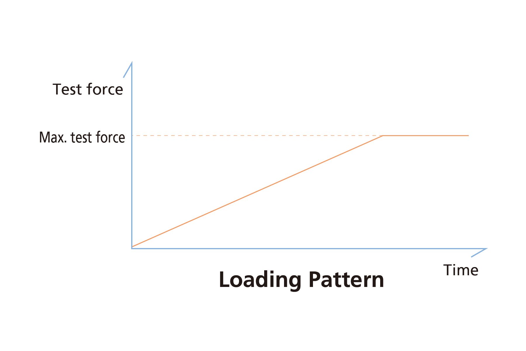

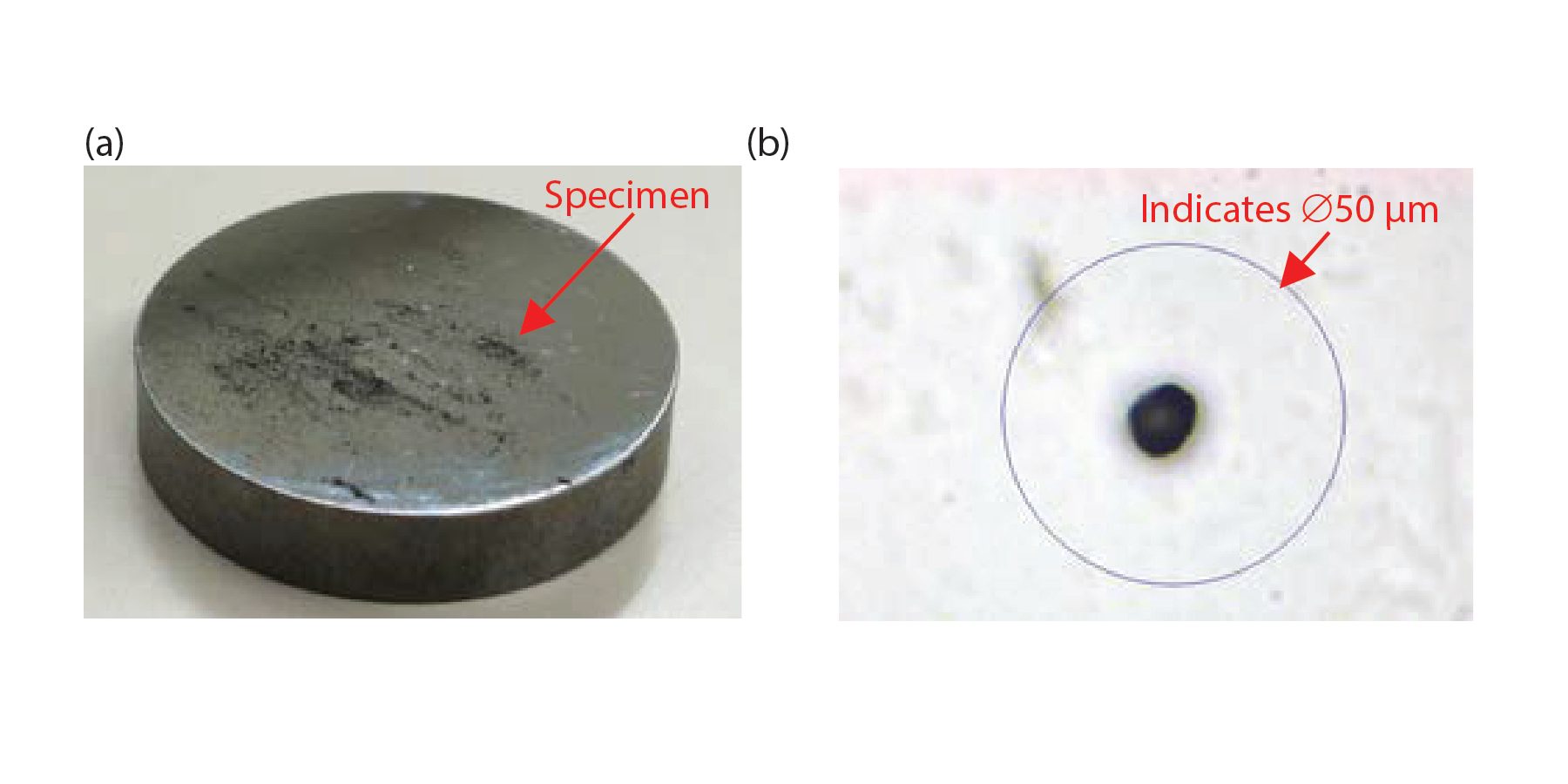

To conduct a measurement, particles are dispersed on the lower platen. Individual particles are imaged and selected for analysis using the top-loaded optical system(figure 2a and b). The particle dimensions are measured, and a geometric mean diameter is calculated. The particle is positioned for testing under the indenter using the X-Y stage. A compressive force is applied to the specimen at a constant programmable rate (figure 3) and the force versus displacement curve is acquired and stored.
Figure 3: Force loading pattern
Figure 2: 2a shows graphite anode material dispersed on the lower compression platen; 2b shows an individual particle viewed prior to analysis.

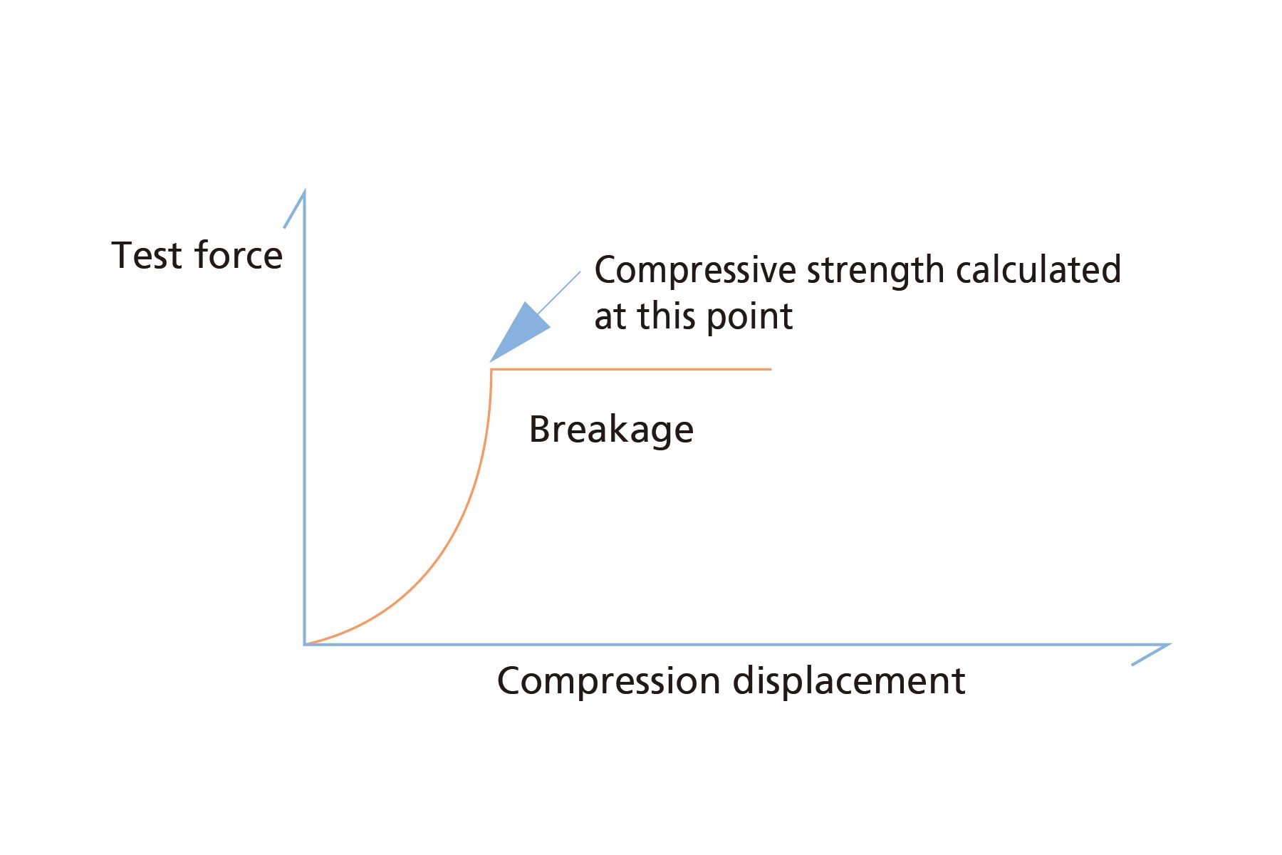

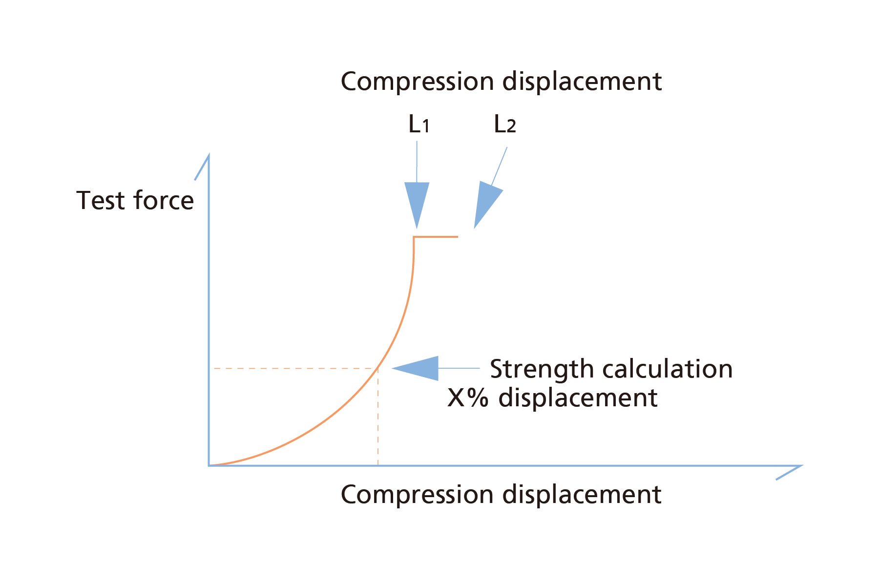

Tests are typically conducted until the sample breaks (figure 4) or until a predefined percentage displacement is observed (figure 5). Particle deformation strength or hardness may then be calculated from established formulae which relate the applied force, displacement, and the initial individual particle dimensions2,3. Cyclic loading measurements may also be conducted.
Figure 5: Force displacement curve without clear break point

Figure 4: Force displacement curve showing clear particle breaking point

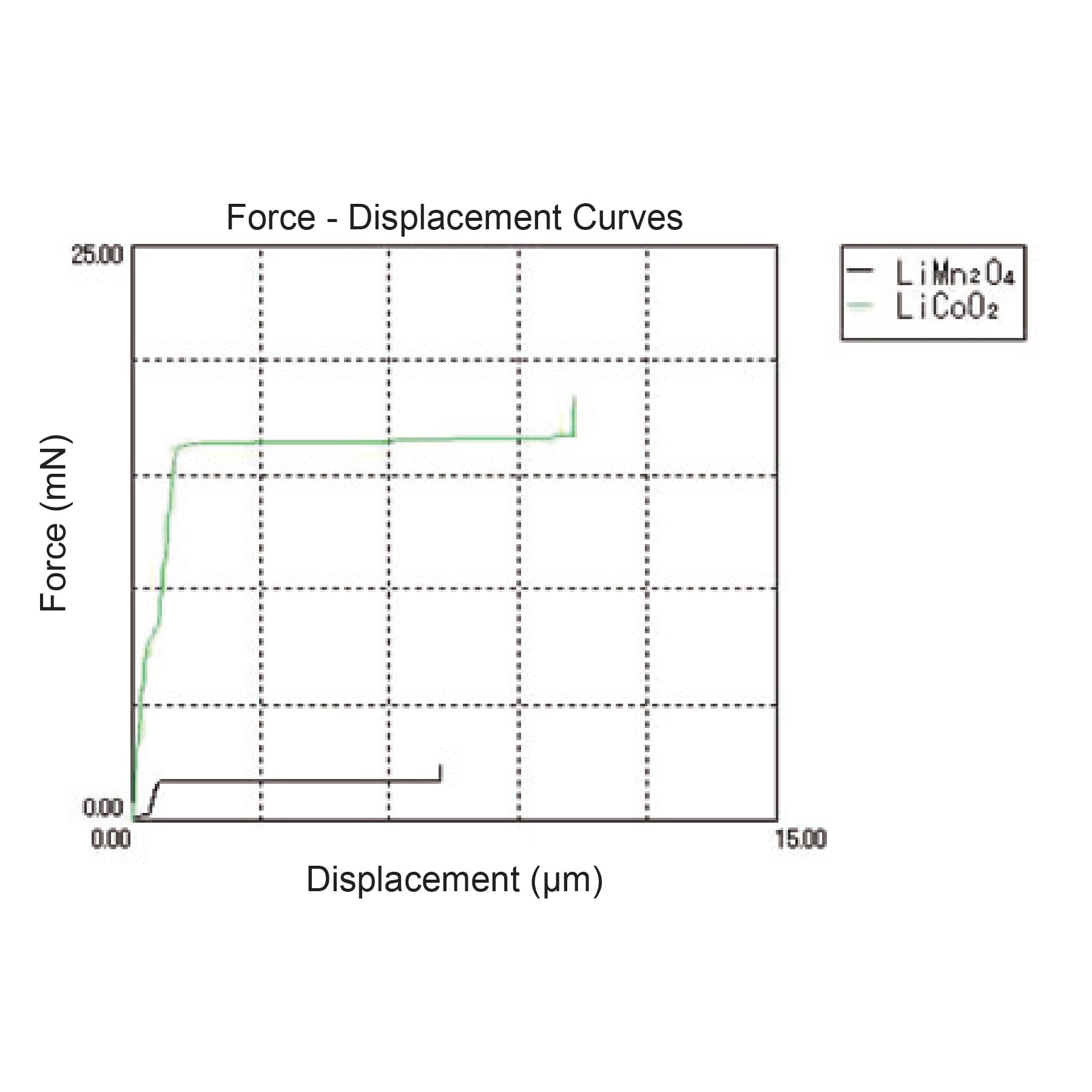

In this example the compressive strength of LiMn2O4 and LiCoO2 particles are compared. The samples were compressed using a test force of 50mN at a loading rate of 2.2mN/sec. The force displacement curve and calculated fracture strength values are shown in figure 6 and Table 1.
The horizontal portion of the force displacement graph clearly indicates the force at fracture. The fracture strength was calculated using equation 1 which is based on JIS R1639-5, Test method of properties of fine ceramic granules, Part 5 compressive strength of a single granule2. The values shown represent an average of ten individual particle measurements. A clear difference may be seen in the strength of the two materials.

Figure 6: Average force-displacement curve comparing LiMn2O4 and LiCoO2 particle strength

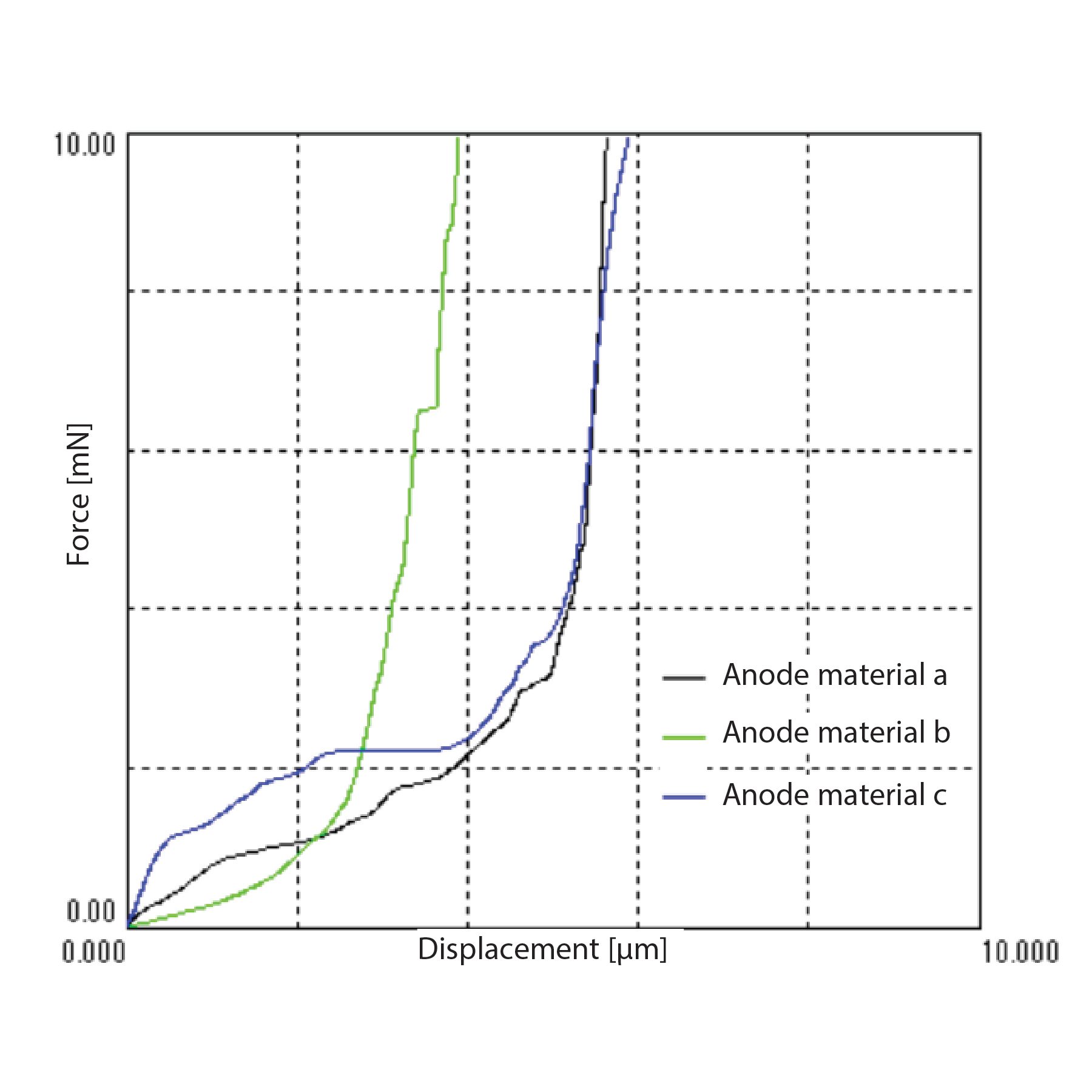

In this example the compressive deformation strength of three different graphite anode materials is compared. The samples were compressed to a test force of 10mN at a loading rate of 0.2331 mN/sec.
When measuring soft materials such as graphite, the initial contact point of the indenter may be difficult to determine, and a clear fracture force may not be discernible from the force displacement graph. In these cases, the deformation strength may be calculated using the equation (2) based on JIS Z 8844 Test Method of Fracture and Deformation of a fine particle3.
Equation 2
σ10% = F10% /A
A = πd2/4

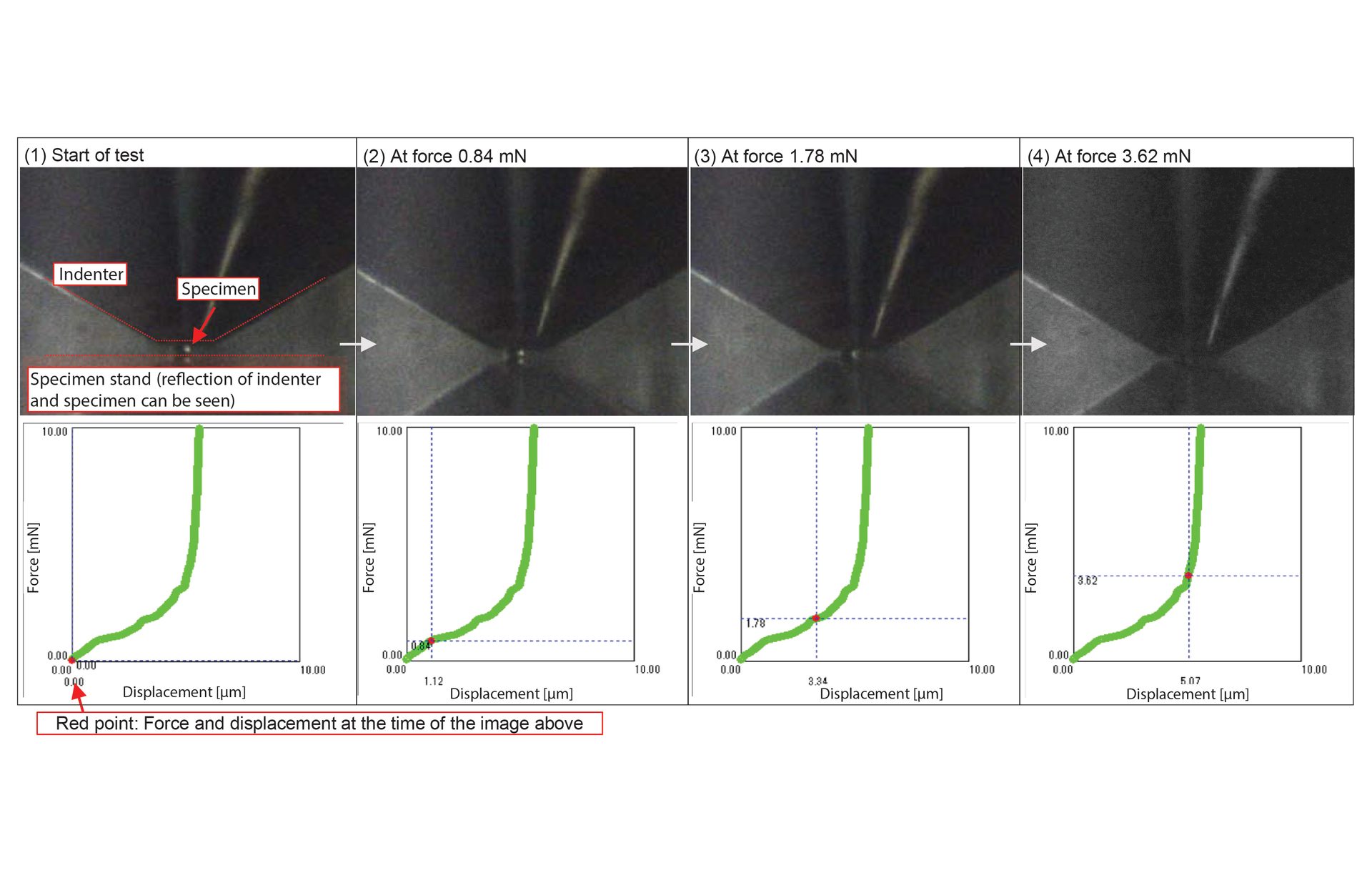

Figure 7 shows the average force displacement graph for three graphite materials. The average size and deformation strength for 10% compression are shown in Table 2. The values represent an average of ten individual particle measurements. Video of the particle tests may be correlated to the force displacement curve. Figure 8 shows a time series of images taken from video of the compression of an individual particle. The associated graphs show the force and displacement for each image.

Figure7: Average force-displacement curve comparing three graphite anode materials
Figure 7: Average force-displacement curve comparing three graphite anode materials
Figure 8: Images from video taken during compression test correlated with force-displacement curve.
