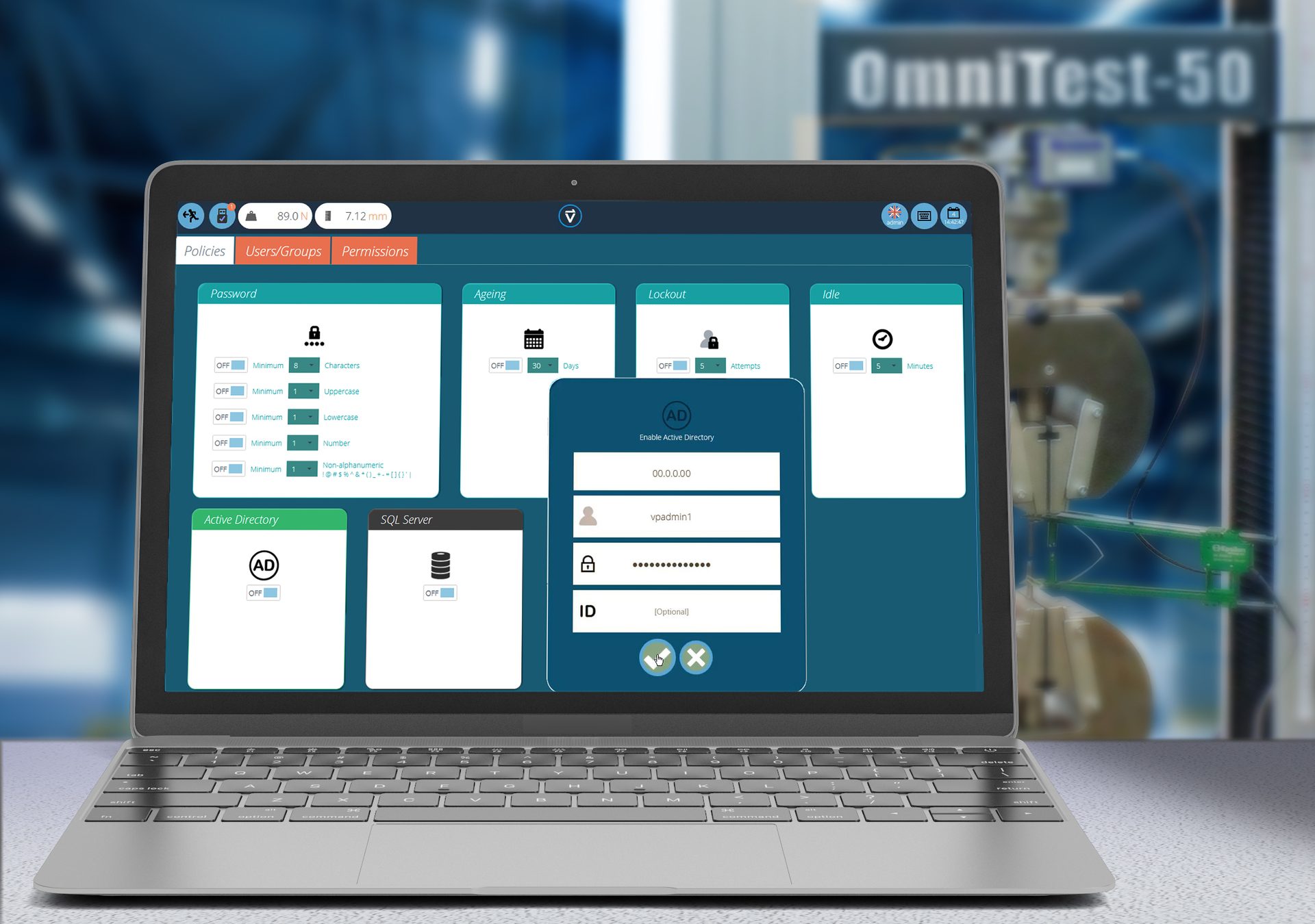

Security — This is the crucial consideration. Software that ensures data is attributable will securely handle multiple user groups and types—enforce best practice password strategies; ring fence access to functions and data based on operator role; maintain time-stamped event logs; preserve test versioning for comprehensive traceability and audit trails. Integrating benchmark applications from developers well-established in IT security, such as Active Directory and SQL Server to maintain the data are worthwhile considerations.
Security is crucial in an enterprise software-driven application. VectorPro Policies, Users/Groups and Permissions screens implement password rules, Active Directory and SQL database access.
