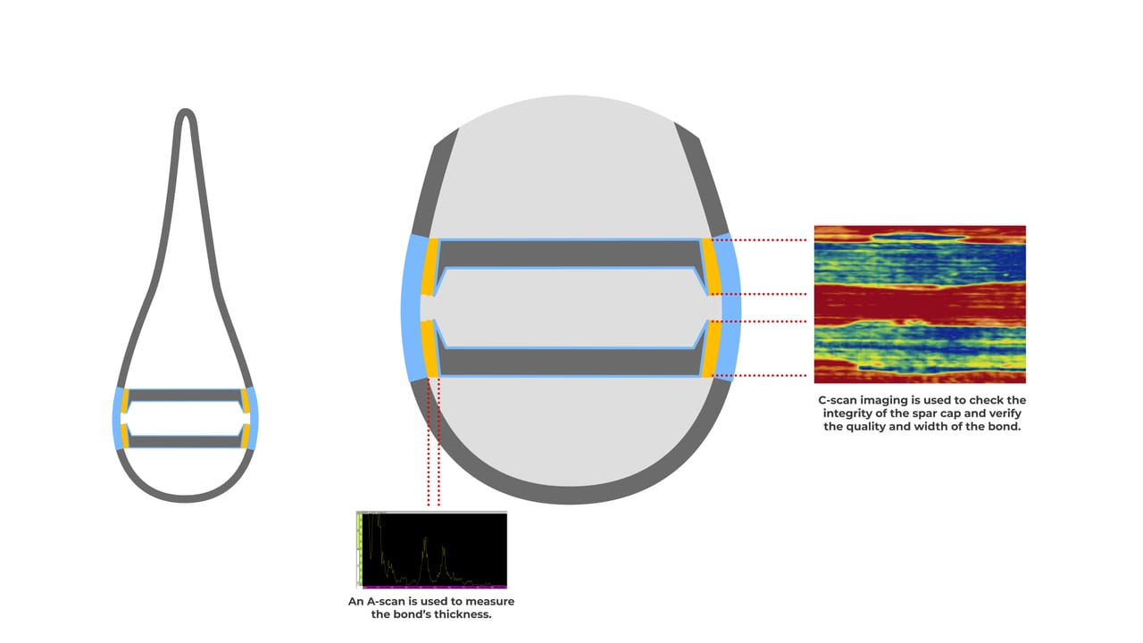

Inspecting the blade’s spar caps and shear web bonding is critical for its long-term reliability. The inspection is typically carried out manually using an ultrasonic probe and flaw detector. A trained operator moves the probe within the region of interest while assessing the live A-scan signal to look for potential flaws. This takes a long time, requires multiple trained operators, and offers almost no traceability or possibility to further analyze the data after it’s acquired.
Figure 1. A diagram showing the inspection points for shear web bonding.

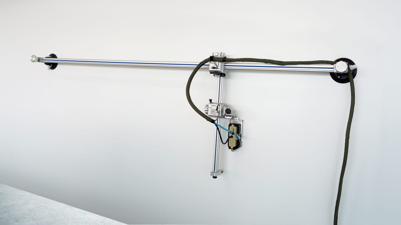

This inspection can also be carried out using a manual or motorized scanner. The advantage of using a scanner is the ability to acquire encoded data (C-scan), which offers both traceability and post-inspection analysis. However, it’s still slow and there are many constraints; for example, the inspector must move the scanner along the blade and position it correctly to acquire accurate, repeatable data.Once the inspection data have been collected, they need to be analyzed. And if there are any doubts or questions, one or more re-scans may be required, adding even more time to the process and delaying the blade’s release for shipment.

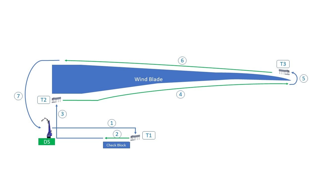

Figure 6 illustrates the complete inspection sequence, including a calibration check step using a block located near the docking station. The check block has its own target. Once the operator launches the inspection sequence, the system moves (1) to the first target (T1), self-aligns to the check block, and scans it (2). The system then moves (3) to the root position target (T2), docks with it, and self-aligns to the blade span. The system scans (4) the web and spar cap on the first side of the blade. At the end of the area of interest, the system stops the scan and moves (5) to the other side of the blade to dock with the tip positioning target (T3) where it then self-aligns with the blade span. The system then scans (6) the web and spar cap on the other side of the blade. When the system reaches the predefined end position of the area of interest, the scan stops, the cobot’s arm returns to its home position, and the AGV moves (7) back to its docking station.
