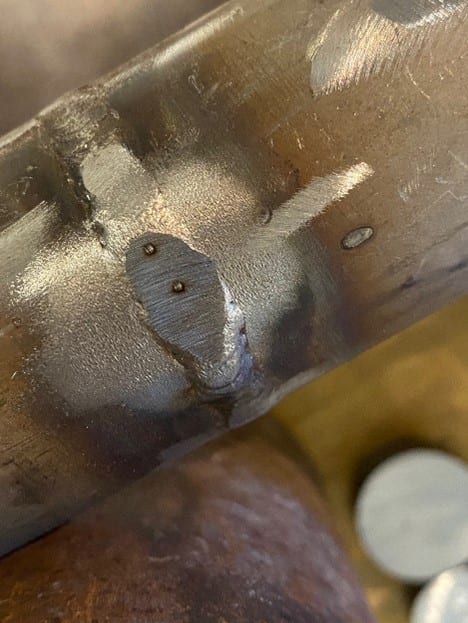

Fig. 1. SciAps Z-902 Carbon analysis of ER308L weld ¼” in width
LIBS is an optical emissions technique that utilizes a pulsed laser to ablate the surface of the material and create a plasma. An on-board spectrometer performs a qualitative measurement of the light from the plasma, separates the individual wavelengths to reveal elemental content, which is then quantified with the on-board calibration. With the recent innovations in handheld LIBS analyzers, which include a very small exit aperture, an inert argon atmosphere is achieved without requiring a seal to curved surfaces or small parts, allowing the technician to test the parts regardless of their size or geometry. The technician prepares the surface, uses the internal camera to line up on the test location, and performs the analysis. With the test area measuring approximately 50 microns, this will allow the technician to measure any size part, including very small parts all without adapters, collecting shavings, or sending sacrificial components to a laboratory.
